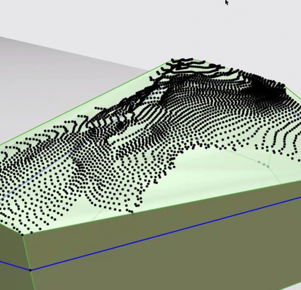

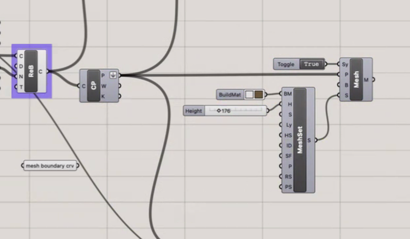

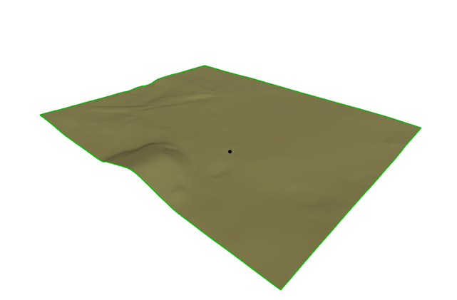

In recent tests, we (Vincent) was using Rhino+Grasshopper to simplify and unify DWG contours, elevated in Rhino, then run through Grasshopper again to get a mesh into Archicad.
We are seeing a major limitation to the Grasshopper plug-in: that only points can be plugged into the mesh script; what we really need is "user defined ridges" as an option.
Anyone have a work-around to get real contours onto a mesh with Rhino? Any GS developers have any influence on expanding this part of the GH plug-in to allow for more usable/versatile/flexible mesh development?
I'll add that Vincent Todosiev (not myself) has been putting in a lot of leg work to figure out this workflow, so I hope he'll be able to chime in here to give more details on what he's done. These are just screen shots I snapped from our last meeting.

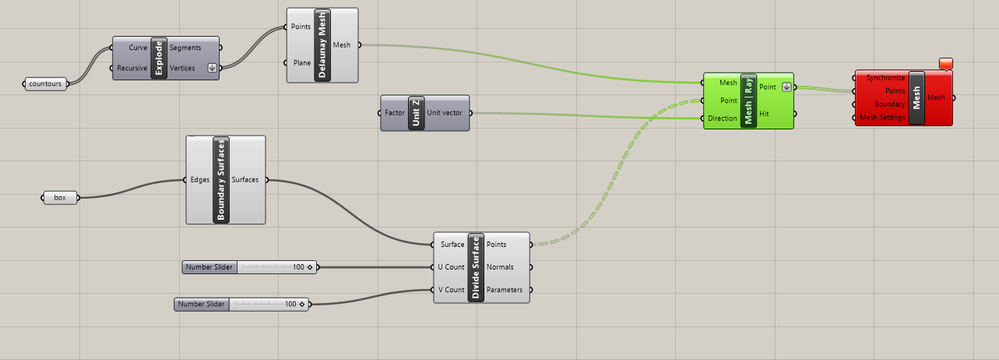

But to be sure - is it the Rhino/GH point generation that is an issue? I usually use an approach where points are generated at the intersection of  the rays from a point grid and a mesh generated from the contours - sort of LIDARing the 3D model 🤔. The number of grid segments gives control of the resolution.

we do detailed site meshes; at least for points closest to our buildable area. I've done extensive tests on polygon thresholds for various elements, and as long as we keep all mesh elements under 100,000 polygons, we do not see them as a factor in file performance.
the whole point of using Grasshopper/rhino is to take a surveys contours that often have excessive points, as you've mentioned, and reduce them down to something reasonable (a contour node every 5-20 feet instead of every 1/2 inch). I understand the imprecision of surveyors provided data, but it is what we have to work from. This rhino workflow saves a ton of time over manually tracing over excessively complicated contours with splines or directly with the mesh tool.
it's all pointless however, if we can't get the user defined ridges into archicad from the archicad/grasshopper plug-in

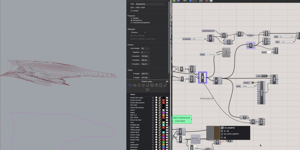

no, we can take the contours (dwg from surveyor) into rhino, then use grasshopper to unify and simplify those contours, and Vincent even set up a grasshopper command to check for polygon complexity before bringing into AC. the only wall we hit is that the plug-in from grasshopper to archicad only allows for meshes to be defined by points, not ridges/contours. so all the contours are turned to a series of single points and we get no floor plan contours for our site plan  documents.

Is there any specific reason for wanting the contours as user defined ridges, apart from the simplicity of just one element? I usually just take them as polylines from Rhino/GH.

using rhino to limit polygons and streamline translation of 2d to 3d. Survey data from txt or xyz has always resulted in a workflow needing excessive formatting and insanely high polygon mesh elements. Rhino and grasshopper make short work of taking a survey with 250,000 contour points and cutting it to 25,000 without losing significant detail or resulting in contours that cross each other, overly straighten curves, etc.
the next step, taking those contours to AC and tracing/magic-wanding with the mesh is pretty straight forward, but the grasshopper/AC connection allows us to take it into AC as a mesh directly; just bummed that it only brings it in as points, which is usesless for anyone who may need to adjust the mesh.
