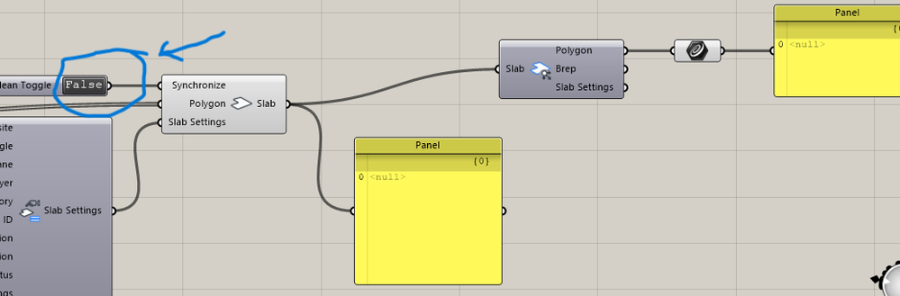

Hi, is it possible to get Grasshopper to indicate when it has successfully generated elements in ArchiCAD, for user feedback?
I see the Design Slab component has an output, but it just seems to display as Null, regardless of what I do.

Unfortunately I can't see the whole script. But I suppose you have several zone polygons as input. Did you check if the sync is on? Then it should deliver an output and the created slabs in AC should also visible in Rhino.Slab_1.png
AC16 - AC aktuelll , WIN 10

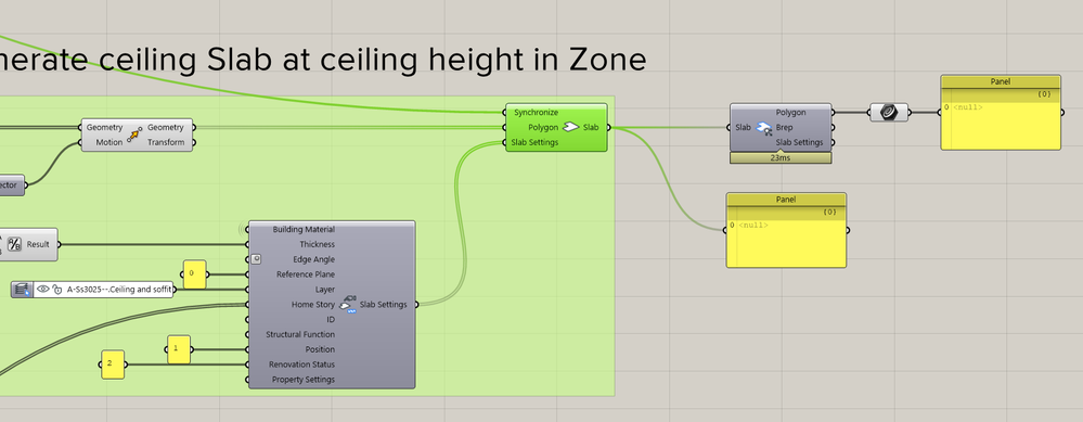

Hi, yes, I'm using the Synchronise as the user input to set the script running, so they'll know that they've clicked it. What I was after was a way of then feeding back through a panel when the script had finished processing and the slabs had been generated.
In the end I think I solved it - I linked a Data Recorder to the output of the slab, and got it to change a boolean flag once the word 'Slab' was picked up by the recorder.
