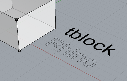

Actual text (there is "text object" and "text block", not to be confused with one another; one is editable, the other makes lines and curves) is a thing in Rhino, but not in Archicad. You would need to use the "3D Text" object from the library for that.
And then there is the "dot" (seen on the cube, sometimes referred to as a point tag) – they have no equivalent in Archicad at all.
