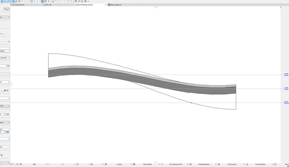

I cant figure out other way than "faking" your composite in Rhino, a merging the 3dm file into archicad (and again, you always can try to import it via connection plugin writing your own GDL object, but it will be less straight forward...)
remember here that the last update of AC21 permit to hotlink 3dm files to the model.
undefined
leceta
section view..
undefined
leceta
wait! connection plugin actually works pretty well with Morphs...

Leceta... I'm lost for words. My problem was probably not using mesh component. You've achieve exactly what I wanted and tried to achieve for past few days. I'm sooo happy! And Thank you sooo much! I owe you at least a few beers! I don't know what to say 'cause it's next post where you help me so much. Like some kind of guru. Thank you again! And if you could tell me whats the component between materials and morph settings Id very appreciate! I'm curious how did you manage to create multi-material morph with different thickness! You made it look so easy... Thank you again!
