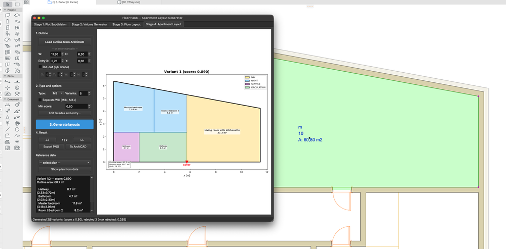

A 4-stage pipeline from a plot polygon (drawn in ArchiCAD) to a complete apartment layout — every output enforces the Polish Building Code (WT 2002, amended 2024-08-01):

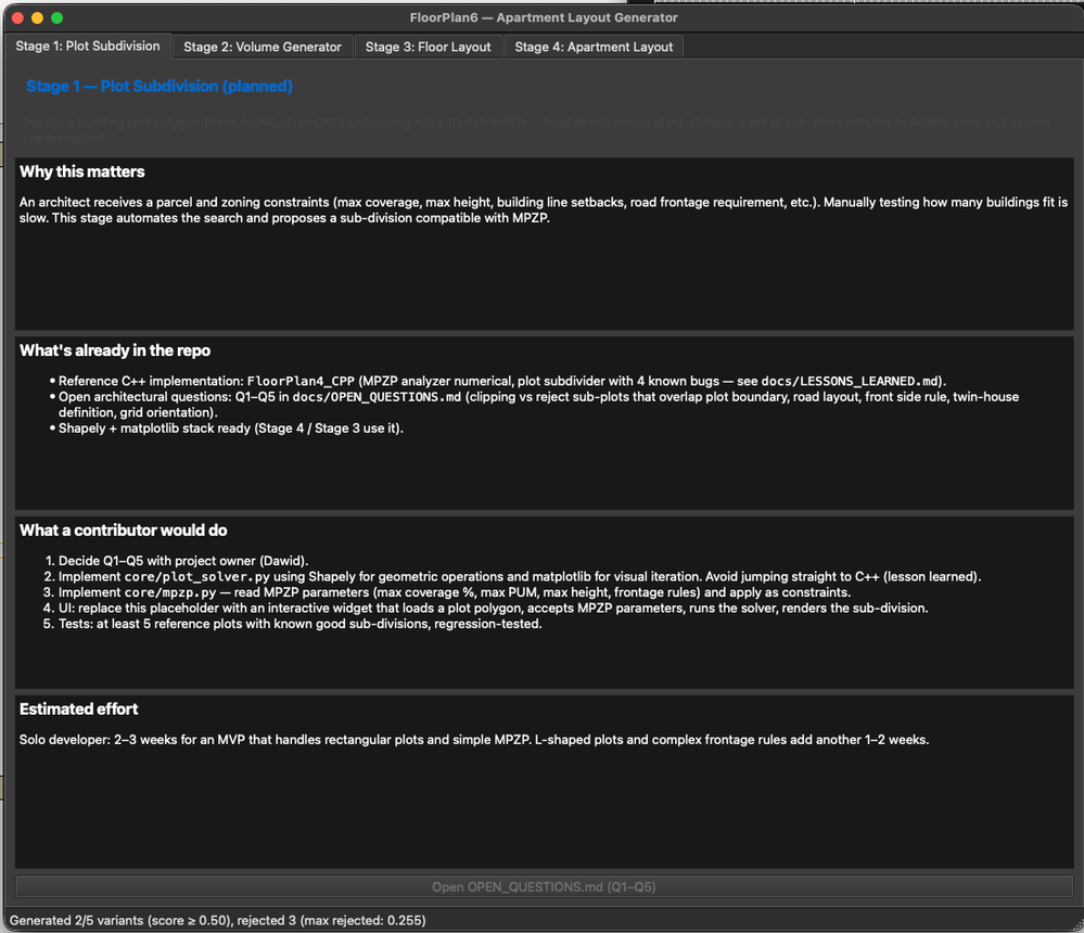

1. Plot subdivision — placeholder, open for contributors

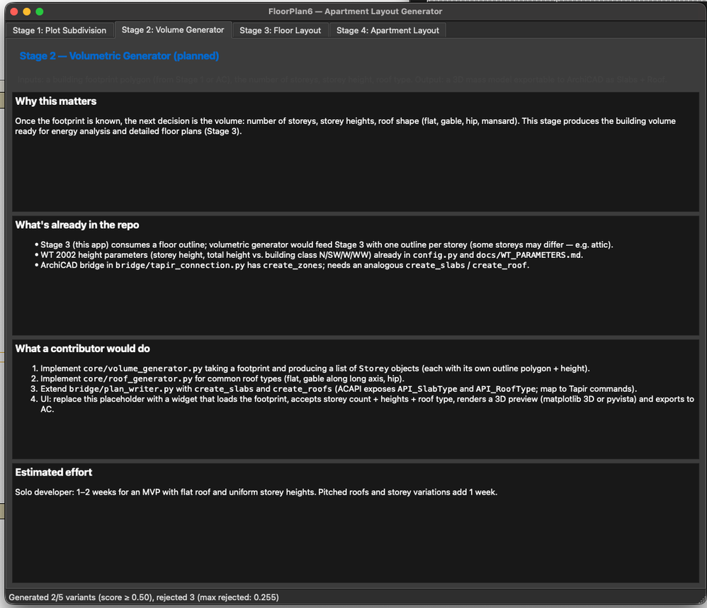

2. Volumetric generator — placeholder, open for contributors

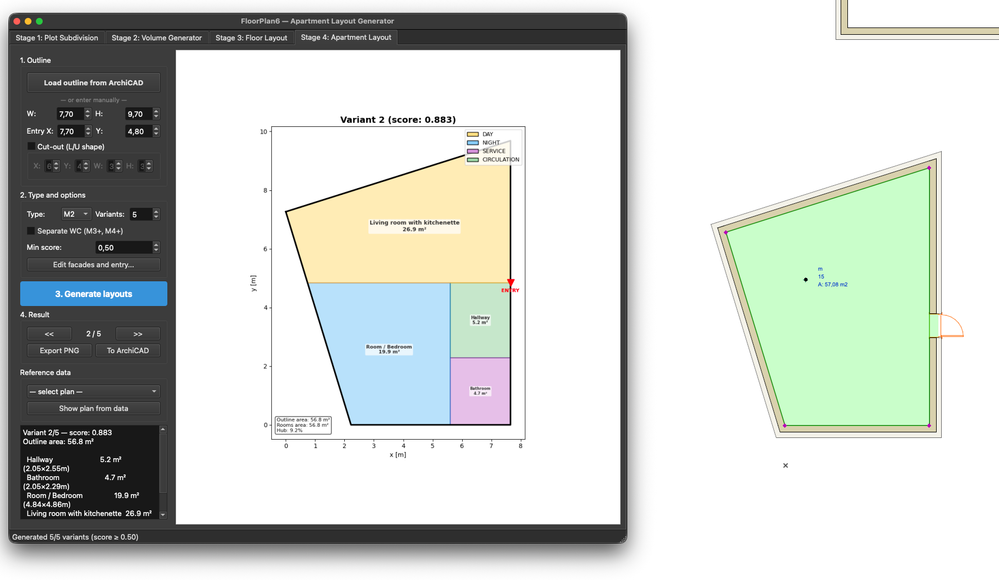

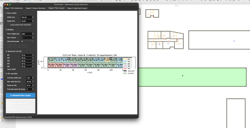

3. Floor layout MVP — divides a floor into apartments with a compliant stairwell, 1.4 m corridor and ≤ 40 m walking distance to the nearest stairwell, validated by Dijkstra

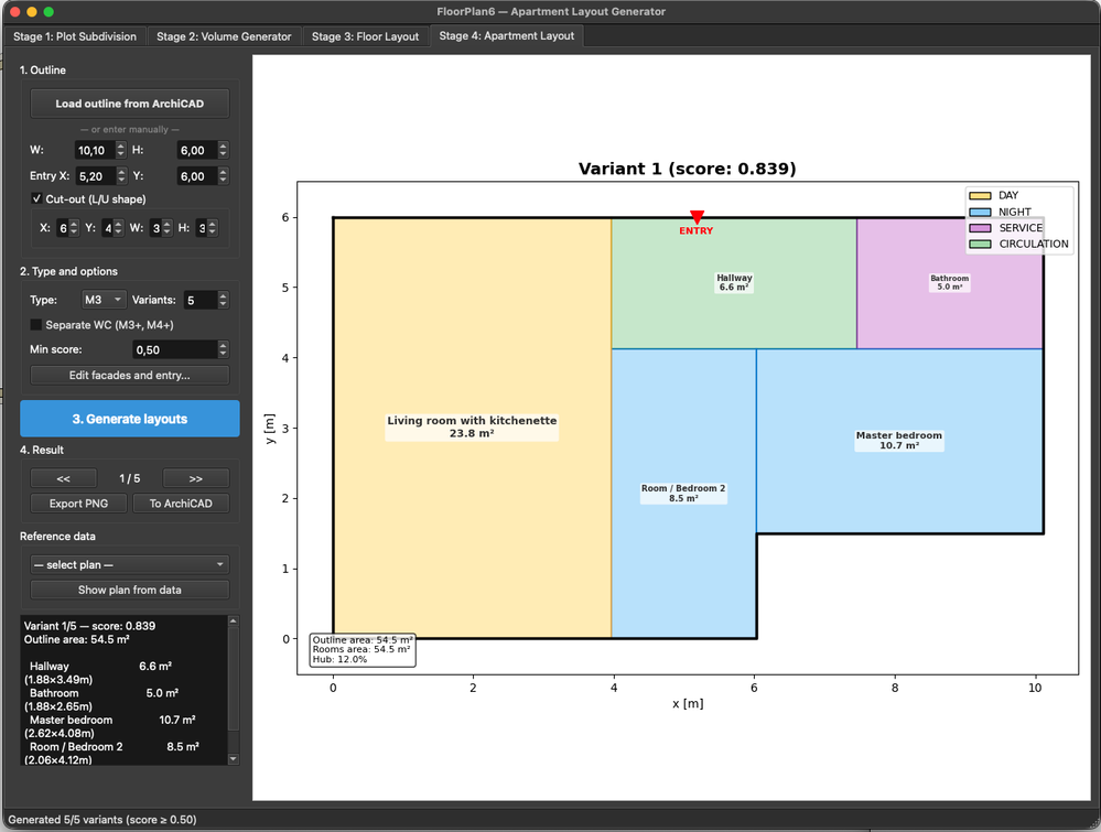

4. Apartment layout stable — CP-SAT solver places rooms inside an outline read from ArchiCAD; 7 templates M1–M5; bathroom hard-capped at 5 m²; living room takes 80 % of the excess area; export back to AC as native Zones via Tapir

Python 3.10+, OR-Tools CP-SAT, Shapely 2, PyQt5, ArchiCAD bridge via [Tapir Add-On](https://github.com/ENZYME-APD/tapir-archicad-automation).
Works with AC 27 / 28 / 29.

  - Stage 1 — plot subdivision (MPZP zoning). Architectural questions
    Q1–Q5 in `docs/OPEN_QUESTIONS.md` are still open
  - Stage 2 — volumetric generator (storeys + roof to AC slabs)

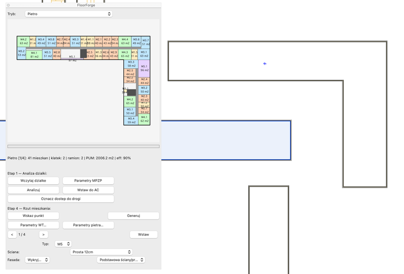

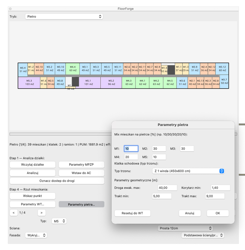

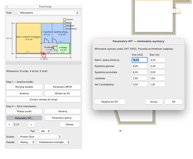

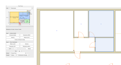

To complete the picture and make everything clear, I'm also adding what I created as a native ArchiCAD add-on in C++. Here's the GitHub link: https://github.com/poolpet/floorplan4/. I'm also attaching the bundle file with the add-on ready for testing — you just need to place it in your ArchiCAD add-ons folder to try it out.
The development story went like this: I started in Python, but it turned out there's no way to create walls there. So once I managed to solve the basic problems with space subdivision, I ported the add-on to C++, where walls and doors insert beautifully. However, a new problem appeared — development speed. Writing in C++, the build time required to test each change was much longer, so in order to focus on solving architectural problems rather than getting bogged down in technical details, I went back to Python, where testing and iterating is much faster. Ultimately, my plan is for it to be a native ArchiCAD add-on, since that will be much more convenient for users than a Python application.
I welcome you to test it, discuss, and help develop my idea.
P.S. The bundle file is for Mac, ArchiCAD 29. Polish language version. If someone needs English version for tests let me know I will try to add English version of test version of addon
