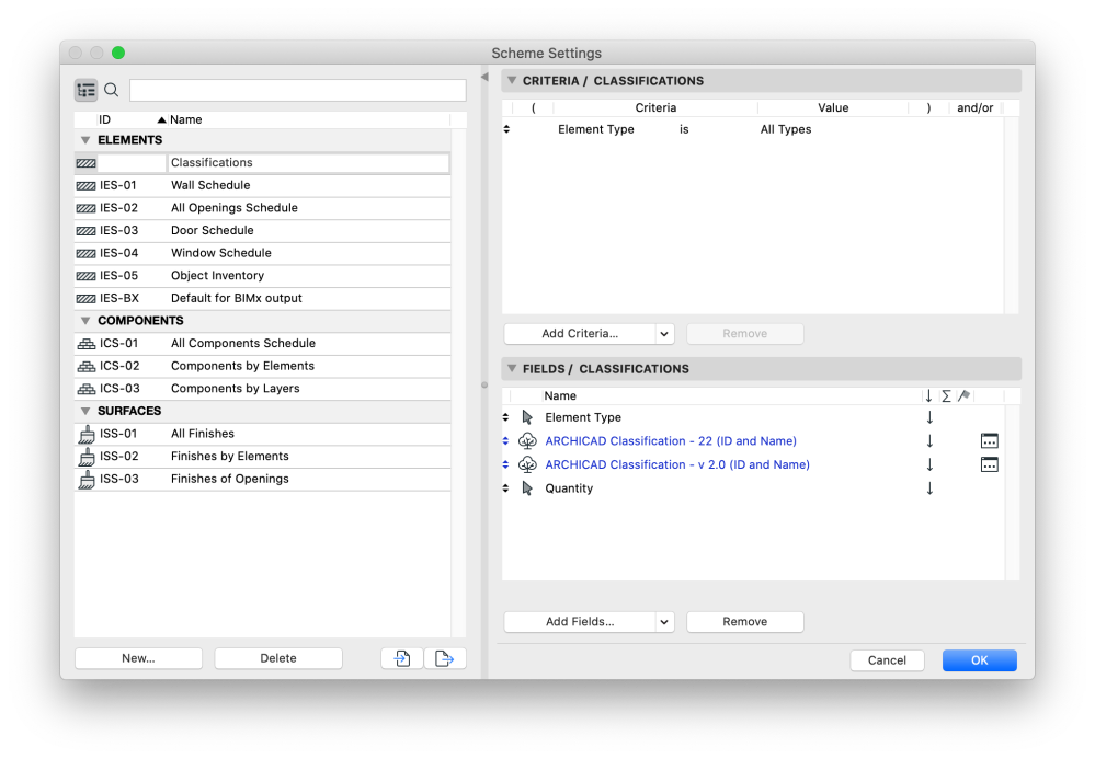

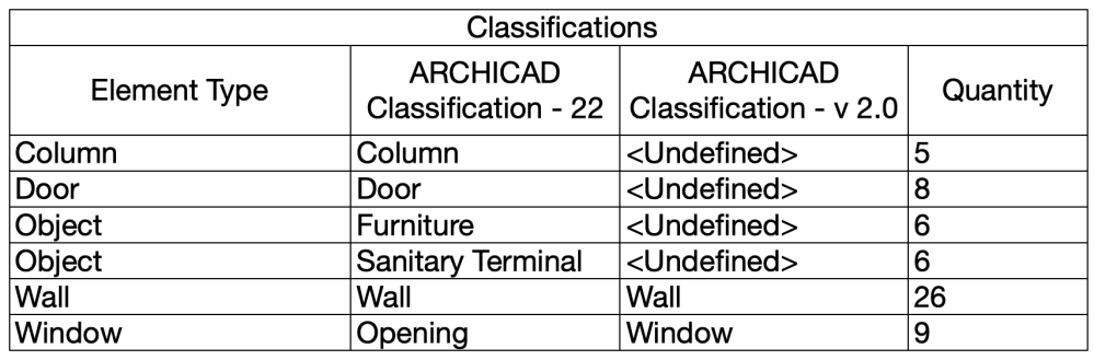

Let’s start with the simplest setup. I have two Classification systems, the earlier is more or less defined, the new one is mostly undefined. Basically anything I created in the new file natively is ok, imported elements are wrong.
I create a Schedule with All Types as a criteria and Element Type, the different Classifications and Quantity as fields.
Merge Uniform Items is on again.
Now my only task is to make sure that the second column has the same values as the first. Whether I can do it or not is a question though, in case of hotlinking the elements will be locked so I can’t set the classifications in the host file, only in the module or the module source itself (the inventory file). In that case I need to do a proper migration in the source or set the classifications if they are missing completely – same as in ‘Setting Classifications using Schedules’.
Assuming that the Classifications were correct in the old content, I may even exclude the Element Type from the Schedule which would allow more rows to merge, for example when I have different Element Types classified as one, such as Walls set as Columns besides regular Column-Columns. Taking off Element Type would spare the extra row in that case and show every Wall and Column classified as Columns together regardless of the original Element Types.

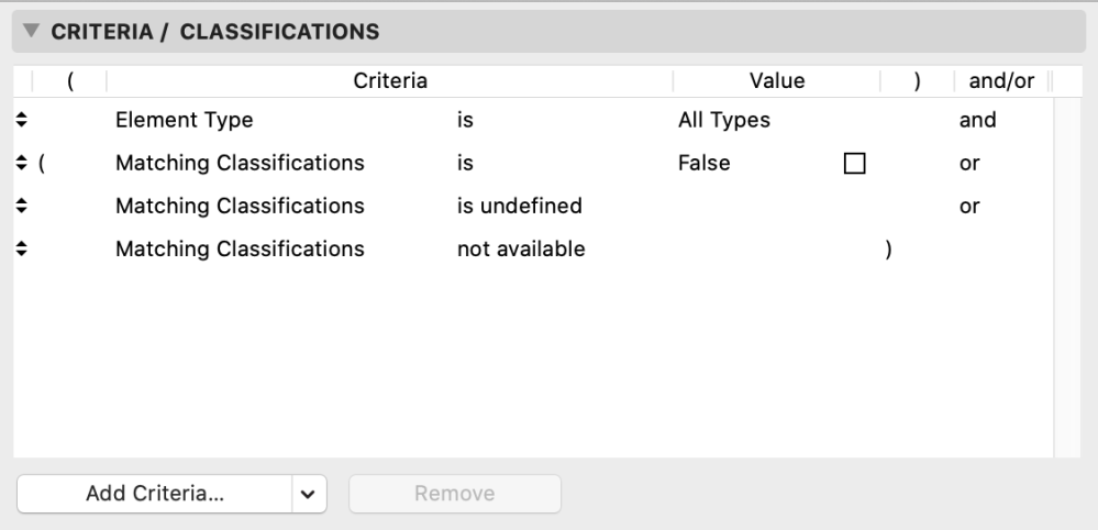

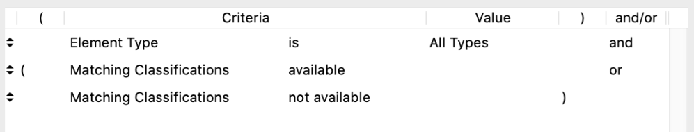

Ideally we should be looking for the all of those that are not True. Let’s reconfigure the criteria. We can’t use ‘not True’ as a condition so have to add the other criterias instead:
Or as an alternative:
The Schedule will look like this (the Walls are gone now):

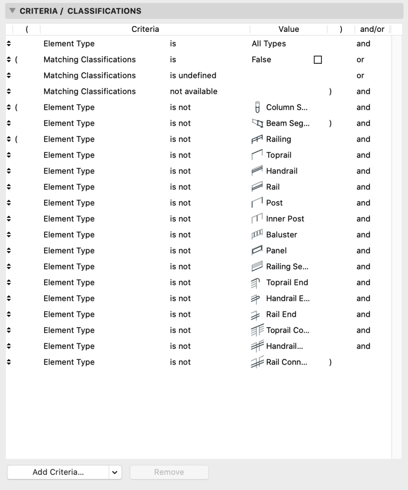

Since the recent Archicad versions include more and more hierarchical tools (new Stairs, Railings, Columns and Beams), you may also want to exclude those from the list too – here it is only the Railings and the Columns and the Beams that are excluded:
Note that Stairs and/or Curtain Walls – as the very first hierarchical tool –  may also be added as exclusions like that, however for the latter frames and panels will be handled differently than Stair/Railing/Column or Beam components/segments, so better not to add them.
The final Schedule – only those will be shown that need some corrections:

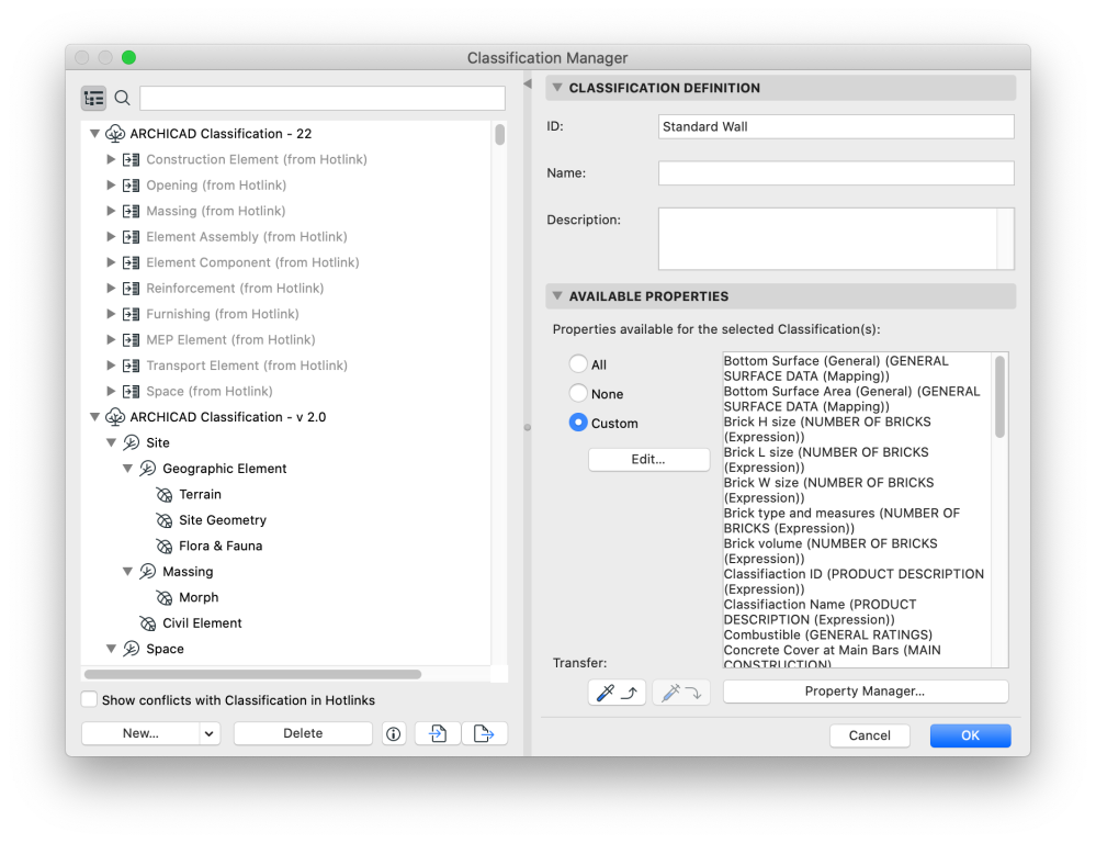

Here is the default system in Archicad 23 (Archicad Classification – v 2.0) and a single item above it for the to-be-imported one, the Archicad Classification – 22. Set its Name as Archicad Classification and the Version as 22, the date doesn’t matter.
This placeholder allows us to add the Archicad Classification – 22 as a field in the template without having any elements using it. Any element in the schedule will be unclassified under that system, but that is perfectly fine as by default we would want everything in the current system, the v 2.0 only, while the placeholder is for the migration only.
If you hotlink the old content, the existing Archicad 22 elements will nicely come under this item.
As mentioned above, those linked elements and their Classifications will not be editable in the host and most be migrated in their original files.
In case of merging (File/Interoperability/Merge…) the old content into the new file you will be prompted that the placeholder system in the host will be spoiled by importing the external system – the emptiness would be replaced with an actual system -, which is exactly what we want since there is nothing to actually spoil – the placeholder is not used anywhere. We can proceed by clicking No:
The system will be nicely imported and will show up in the migration schedules correctly as well.
