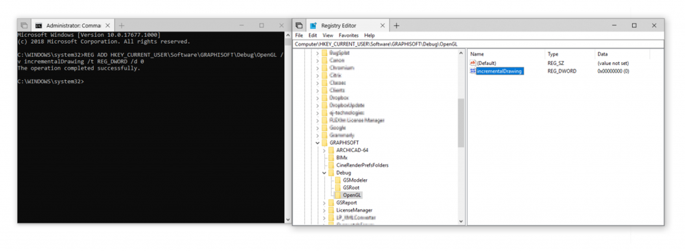

on Windows
You must edit or add – if it does not exist – a DWORD (32-bit) type value named incrementalDrawing with 0 (if you want to switch off the feature) or 1 as value in HKEY_CURRENT_USER\Software\GRAPHISOFT\Debug\OpenGL key. The parent key(s) should be created before if they do not exist. Restarting ARCHICAD is needed after the modification. You can use the following string to modify or create the Registry key without opening the Registry Editor. First, start Command Prompt as an administrator with the following steps:
  1. Open Start.
  2. Search for Command Prompt.
  3. Right-click the result and select Run as administrator.
If you want to switch off Incremental Drawing paste this into the Command Prompt window and hit Enter (if the value exists, you will be asked about overwritten – write a Y and hit Enter again):
REG ADD HKEY_CURRENT_USER\Software\GRAPHISOFT\Debug\OpenGL /v incrementalDrawing /t REG_DWORD /d 0
If you want to turn on the feature, use the string above but change 0 to 1 at the end.

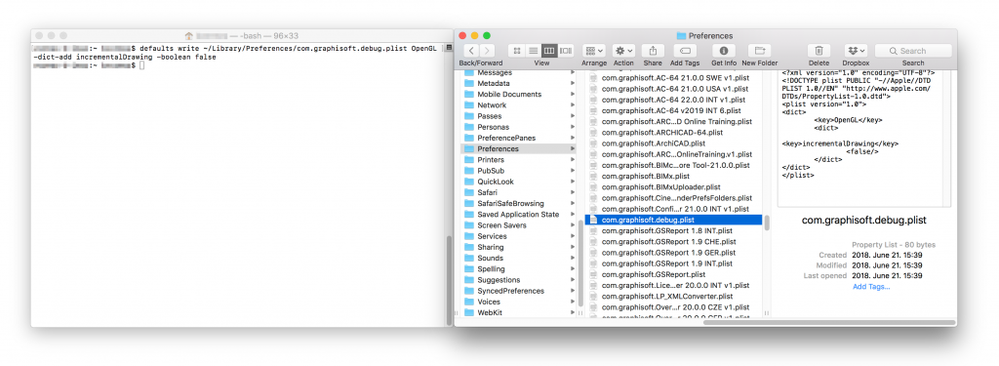

on Mac
You must edit or add – if it does not exist – a key named incrementalDrawing with ‘false’ (if you want to switch off the feature) or ‘true’ as value under OpenGL dictionary in ~/Library/Preferences/com.graphisoft.debug.plist file. The dictionary should be created before if it does not exist. Due to caching processes on Mac, restarting the computer is needed after the modification. You can use the following string to modify or create the Preferences file. First, start Terminal with the following steps:
  1. Open Launchpad or Spotlight Search (Cmd+Space).
  2. Search for Terminal.
  3. Hit Enter or double-click on its icon.
If you want to switch off Incremental Drawing paste this into the Terminal window and hit Enter:
defaults write ~/Library/Preferences/com.graphisoft.debug.plist OpenGL -dict-add incrementalDrawing -boolean false
If you want to turn on the feature, use the string above but change ‘false’ to ‘true’ at the end.
