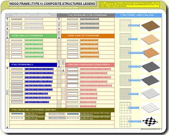

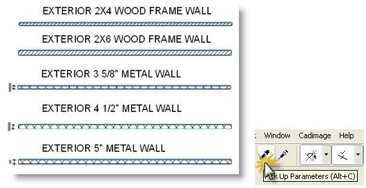

A complementary approach, also discussed in that article, is to set up an Interactive Legend of Visual Favorites. These arrays of elements may be samples of walls, slabs, roofs and other structural components, or examples of library parts (freestanding objects, or doors and windows placed into walls). By having them in a visual display or "Legend," one can peruse and choose the most appropriate one, then pick up their settings using the eye-dropper (ALT or OPTION click).
Whether using Favorites or Interactive Legends, office standards (or project standard wall types, etc.) may be easily applied. A user will not have to spend time figuring out how to make the wall, window, dimension text, or other element have the right line weight, size, linetypes, layer, etc. Proper usage will reduce the common problem of inconsistent settings: e.g., some walls being drawn 4" thick, others 4 ½" thick; objects being put on incorrect layers or pens; text being different sizes; etc. In addition to preferred element settings (which mainly involve attributes), the structure of the file is an equally important part of office standards. This structure includes View definitions (including Model View Options) and how these Views are placed and numbered on layouts using Master Layouts in the Layout Book.

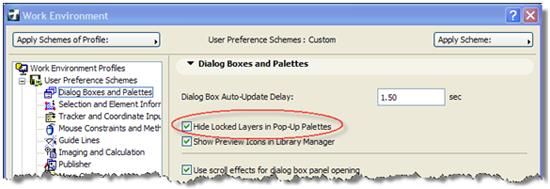

  • 1 Show and unlock all layers

In a similar way, Views in the View Map define more than just the Drawings that will go on the Layout sheets. Specialized Views are set up to jump to the Interactive Legends of Visual Favorites, giving quick access to the office standard walls, windows, doors, furniture and other elements. There are also preset views for various 3D angles and display options—some of my favorites use layer combos that turn the roofs or walls into wireframe, so that one can see into the building for presentations and study.

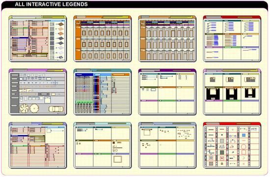

Clone folders (see my AECbytes article from November 2007) are set up in MasterTemplate to automatically create more Views as needed, with all the right settings. That way, as more sections are drawn, or more interior elevations, etc., there are always Views ready to be edited and placed onto Layouts. The Interactive Legends of Visual Favorites are an area we spent a lot of time developing. They are comprised of a number of groups of elements, with each group organized in a legend panel. These panels are carefully sized to keep the text readable when viewed as a whole onscreen. One can use the eye-dropper to pick up the settings of a desired element, then return to the building and place or draw the element.
Each panel focuses on related groups of elements, such as walls and other composite structures, doors, windows, objects, room layouts, etc. The legends are extensible so that users may add to them as they wish.
These legends are maintained in a separate Hotlinked MOD file for two reasons. This allows them to be updated throughout the office from one location. It also allows the legends to be turned off instantly by hiding the Master Layer of the Hotlinked Module. That way the legend elements are not seen in 3D views, elevations or sections, even though these elements are on the same layers as the building design itself. In MasterTemplate , the Layout Book is structured for two different project types: a small project with sequential sheet numbering (A.01 through A.15), and a larger structure divided into subsets (e.g. A300 series for Plans, A400 series for Elevations, etc.). One can simply use the appropriate set of sheets, and discard the others. Many pieces of boilerplate text are pulled from File > Info > Project Info, so one can simply fill in the Project Info (or have an administrative person do it) and the sheets will have that data already entered. Since Project Info can be saved to an XML file and loaded from the XML, this data can be carried from one project to another very easily. The general notes and specifications for the project are set up ahead of time linked to a PDF file. The notes are prepared in Word, with a custom page size matching the columns on the layout sheet, one page equaling one column. When the Word document is saved as a PDF, the layout sheets receive the updated contents. This way, the specs can be written and maintained in the word processor and there is virtually no time spent getting them onto the sheets.

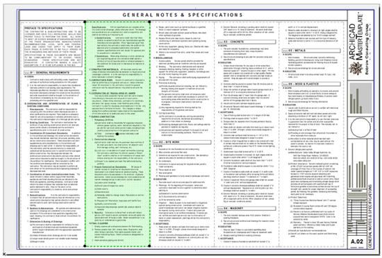

Many of the Layouts have Drawings already pre-placed on the sheets. With a robust template, you can focus on designing and making a 3D model for your project, annotate it, and the views are already laid out for plotting. In fact, in one dramatic demonstration, I took an entire building model from a different project file, and pasted it into the ARCHICAD MasterTemplate file. When I went to the Layout Book and asked it to update the drawings, the plans, sections and elevations were pretty much all laid out ready to go. The ARCHICAD MasterTemplate is an example of how far one can go with a template system. Any firm can develop its own template, and refine it over time to become more powerful. It just takes time and effort, like all good things in life!
