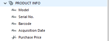

‎2024-01-28 11:20 AM
They are 'Properties'.
You can create/amend them with the Property Manager.
Each Property needs to be made available for particular classifications (or it can be all classifications).
You then assign a classification to each element.
Once an element has been classified with a particular classification, you will see in the element settings all of the properties now available to that element because of that classification (in the classification and properties section of the element settings).
You can now give values to those properties for that element.
