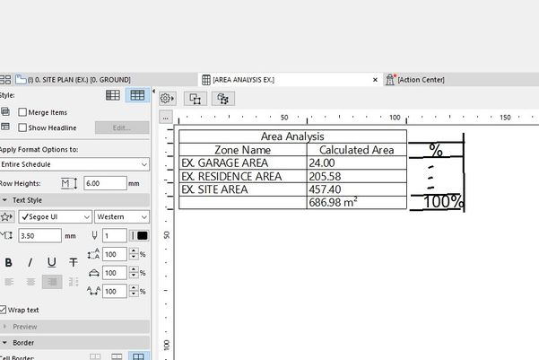

How do you add a percentage column to a zone area schedule? Where each zone/area is a percentage of the total site area?
Please see attached.

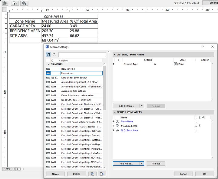

1 ACCEPTED SOLUTION
Solution
This is what you need to do.

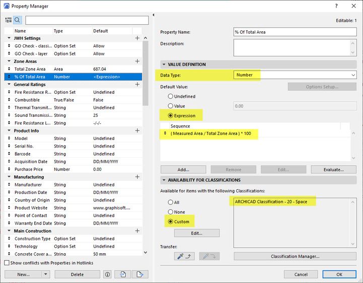

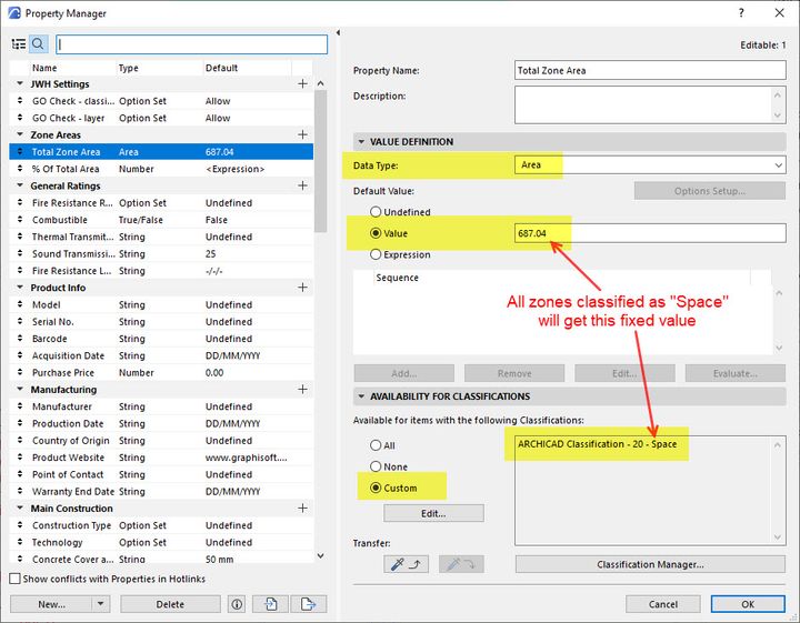

Zones can not talk to each other and schedules can not do calculations, so you have to set it up with properties with expressions as Lee mentioned.
You need to create a fixed property for zones where you can manually set that property value to the overall area of all of your zones.
Then set up your percentage expression, based on the actual zone area as a percentage of the total area property.
See the Help reference for a similar example ... https://help.graphisoft.com/AC/25/INT/index.htm?rhcsh=1&rhnewwnd=0&rhmapid=#t=_AC25_Help%2F045_Prope...
Except is it not quite the same - the 'mandatory glazed area' which is a fixed value, will become your 'total zone area' fixed value.
If your total zone area ever changes, you will have to manually adjust that fixed value.

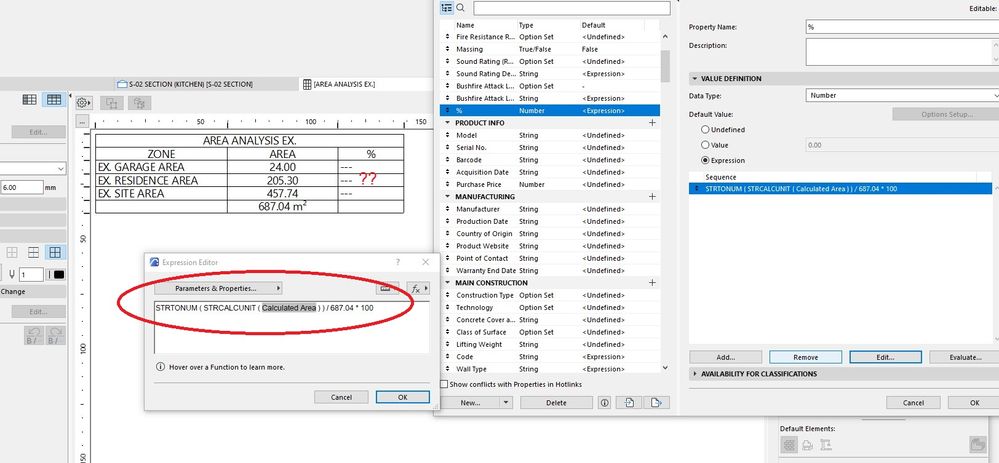

Hi Barry,
I've created a new property in "General Rating", but it's like the schedule can read the property to populated it?
Please find attached.
Use "Calc Area" --> convert unit to String --> convert to Number ...
