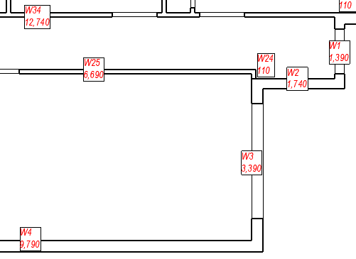

I have placed a number of modules into my master file and am creating Wall Schedules for each of the dwelling types. However, the schedule is showing a multiplication of the wall length by the number of that module placed.
For example, I have placed four 'Type E1a' modules and the length in the schedule is 4 x wall length (see screenshot below). Wall #1 "W1" length is 1,390mm however the schedule is showing 5,560mm (4 x length).
How do I alter the criteria/fields to show the correct length?

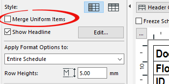

Have you turned off 'Merge uniform items' in the schedule settings?
Hi Barry,
Thanks for helping! Unfortunately when I deselect that item it shows all four instances of "W1" like the screenshot below. I'm after a list that shows walls numbered consecutively W1, W2, W3... as per my second screenshot.

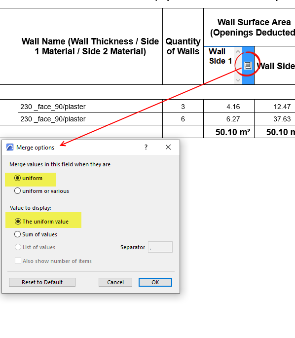

OK, leave 'Merge uniform items' on.
Click on the 'Lengt' heading and hopefully there will be a button for 'More Options,.
This depends on what version of Archicad you are using.
If it is there set it as this ...
