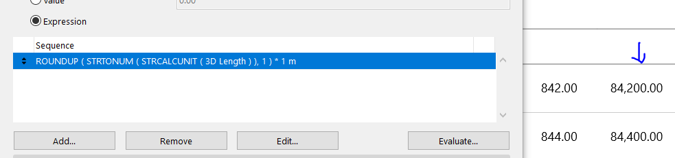

qingdom
Continuing to round up i get to the beams which had a premade property called segment round with the expression below. I need it to round up the nearest .5 for example 842 should show 845 cm, 844 should show 845 cm. How can i change this formula cause now it is showing the same number on the column on the right.
Thanks

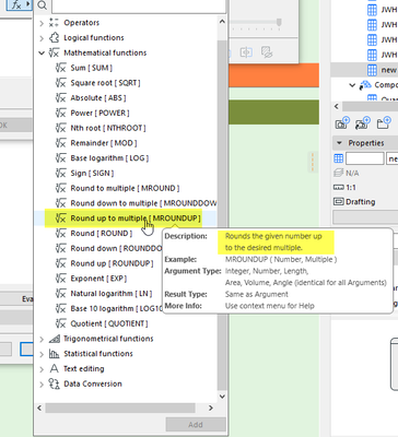

I haven't really played with this but I think you might want to use MROUNDUP instead of just ROUNDUP.
You are also multiplying the result by 1m (1000).
That is fine if you want to do that.
