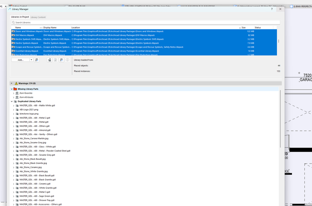

I would assume some macro is missing. What are the library warnings? Are there missing objects?
| Win11 | i9 10850K | 64GB | RX6600 | Win11 | 7800X3D | 32GB | RTX5070TI |

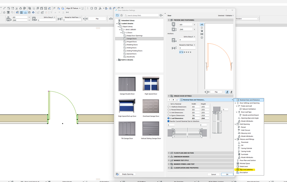

a week ago - last edited a week ago by Barry Kelly
How would you go about fixing that?
There are no missing parts that have anything to do with the doors. I have included a screenshot of the door setting not showing the option Tags and Labels compared to default Archicad template which shows it

What are those warnings?

I'm with Ling.
Check the warnings in the Library Manager.
The 'Tags & Labels' in the door settings is controlled by the library object and macros.
I suspect something is missing or maybe something is doubling up with old and new libraries and causing this issue.
Don't be using the 28/29 Global libraries together with the old 27 or before monolith libraries.
Confusingly the old monolith library in 28 was called 'Library 28', but it is actually the old 27 library.
It will use the old macros and may conflict with the new macros in the global libpacks.
But expand the warnings to see what that tells you.

These are just missing Attributes and objects which shouldn't affect it
Wednesday
Hi Barry
I have review the warning signs and it is only attributes and objects missing but nothing to do with Library objects or macros missing !
Wednesday - last edited Wednesday
Lots of duplicate library parts.
There ideally should be none.
And lots of MASTER_GDL objects, these can have strange effects on library parts.
Not knowing your project, it is hard for me to say what you need to delete to clean this up.
You can expand those further and they will give you a path to where they are located.
They are probably in your embedded library.
If you start a new file from a clean Graphisoft template in 29 and have no issues, then that leads me to believe it is a problem with the loaded libraries.
Experiment a little and start deleting objects from your embedded library.
When you select them you will see if they have been used or not in the project.
Especially delete the MASTER_GDL files.
See if that makes a difference.
Don't save the project (or play with a copy), unless you are happy with the outcome.
Maybe create a backup copy of the original file so you have something to come back to if it all goes pear shaped.
Barry..
Wednesday
And the library screenshot in the file that does work is not reporting any library issues.
