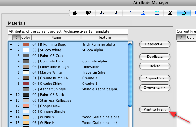

You can export some or all attributes as a tab-delimited text file via the "Print to File" button in Attribute Manager (screenshot).
The saved files can then be compared using a file difference program. On Macs, diff and sdiff, for example, are built-in and available under Terminal. The tricky part is that the text "in use" preceded by a tab will appear for any attributes that are in use in the file from which you exported from AM ... and will cause otherwise matching attributes to look like they are not the same...

For example, I saved two files - materials1.txt and materials2.txt from two different templates. I opened Terminal into the folder containing the two files and typed: diff materials1.txt materials2.txt and obtained what follows here. Where a line begins with "<" it means that that line is uniquely in the first (left) file. Where "> the line is from the second (right) file.
The initial lines are in pairs - the materials are the same in both files - but in one or the other the material is "in use". So, we just need to strip off that text in order to find which materials actually differ between the two files...

You could manually strip out the "[tab]in use" even in Word or Textedit, but if this is something you'll do all the time, it would be better to write (or if someone here donates) a script that strips that and does that comparison.
After stripping, for the example below, only the following lines show up via 'diff', showing the new materials assigned at ID's 122 and above in one of the two files.
Note that this method doesn't show any fill associated with the material, won't tell you if someone altered the LW settings, etc.
