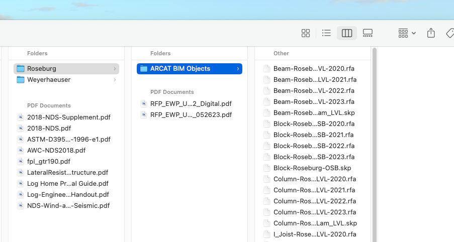

hello - recently downloaded some BIM stuff from Roseburg (EWP-engineered wood product) mfg. that we heavily utilize. Trying to learn or figure out how to access these files in AC27 (*.rfa; *.skp)? I did add the folder to the library but not sure what next or if even any of these extension files can be coordinated with AC27.

BIMComponents can be access directly from the native tool search. The objects are native to AC. In regards to the doors and windows, most of them should be adjustable much like the ones included in your default library.

ok i found this but was hoping i could simply select the entire folder. if this is the soluion then please disregard post...
https://support.graphisoft.com/hc/en-us/articles/23550940198033-How-to-import-an-RFA-into-Archicad

I can't find exactly what type of product it is or the contents of those .rfa or .skp files, but my suggestion is to replicate those specifications with Archicad's native tools. That is, if they are structural profile sections, create them as complex profiles; if they are building surfaces or materials, add them to your attribute collection. This way they will always be part of your template and will run smoothly in the software. Sometimes third-party objects are full of useless geometry and data.

they are related to Revit and Sketchup from little research i have done so far. not critical but at some point would like to use 3rd party vendor images, details and technical specifications to add to my set of documents.
