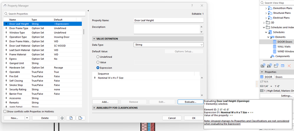

I think there is a bug in the Expression Editor's Text Editing Functions - when trying to use the 'Nominal W x H x T Size' property of a window or door, it evaluates as just the '× ×' characters.
These are not regular x's but unicode U+00D7, or multiplication signs.
I though this might have been because of the double quotation marks that come as part of the door/window size, but this happens even with working and calculation units set to mm.
(I am trying to split this into separate width and height to suit our office's convention for door / window schedules.)
1 REPLY 1
