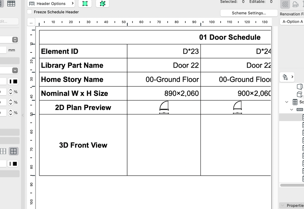

Hi everyone,
I am having trouble with my schedules.
Everything is showing on my door schedule apart from the 3D front view, it just shows a blank box.
Can anyone assist?
Thanks.

Hi Jordan.
Make sure that your elements are visible, E.G Layers and Renovation filters etc. must be set correctly, as they will affect the listing of elements in the Schedule.
For the same reason, it is adviced to save the Schedule as a View 😉

As @Thomas Nymann  has suggested you should save the Schedule in the View Map with settings that allow you to fully edit the contents of the Schedule (if that is what you want to do). Consider the Schedule as an elevation / section drawing which means you need to turn on and unlock what you want to see & change and don't forget your MVO settings which also have an effect together with pensets, partial structure display etc.
