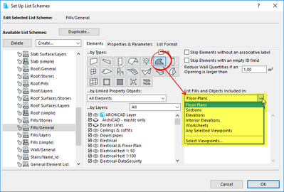

The old 'List Scheme' can look for fills in elevations and worksheets.
It is so long ago that I used it, that I can't remember how it was all set up.
I can say it does still work, but it is very old and hasn't been supported for some number of years.
New tools like the stairs, rails, openings aren't included.
I am not sure about the updated curtain walls (although I think they are OK), beams and columns.
But fills and objects should work fine still.
I wouldn't be surprised though if this functionality is removed in future versions just to clean up the program.
But that is pure speculation on my part.
