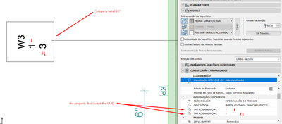

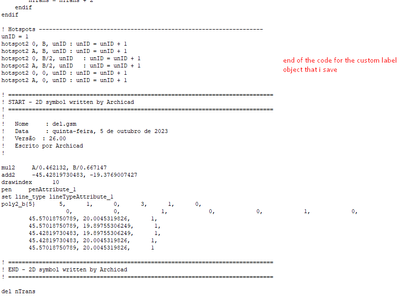

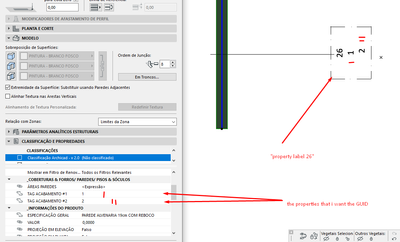

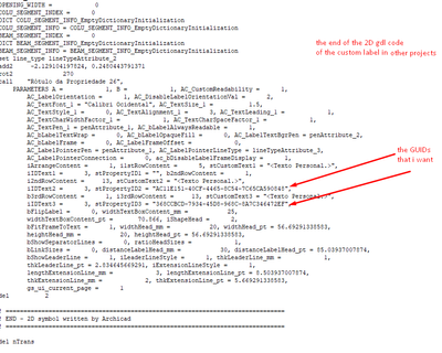

To find the property GUID, I usually use the 'property label 26' in an object, select which property I want, and save it as a custom label. So, when I open its GDL 2D code, I can find the selected property GUID to use in other objects that I'm creating. However, in this frustrating project (which predates my template in the office), when I save the custom label, it doesn't show any GUID. Does anyone know why or another way to find a property GUID?
Just to illustrate what i'm saying:
this is when it works, and the following images are when it doesnt work...
whyyyyyy

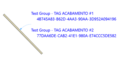

Hi Otavio!
Not sure why your way is not working, but I've attached you a label object which can give you the property GUID in a different way.
Just use it to label some element which has access to the properties, similar to my screenshot:
To make the object yourself, you can paste the following code into the 2D script of new label object.

Hope that helps!
Bernd
