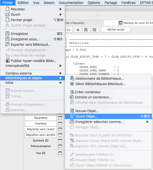

Hi Malin,
Sorry I opened the quantity_text_writer macro by keyboard shortcuts.
To open it you must do the same operation as you did with "Zone_stamp_macro" (see screenshot)

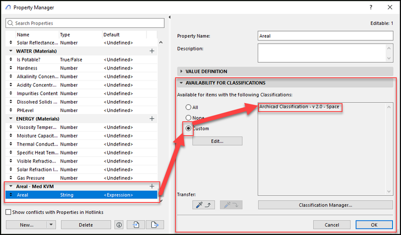

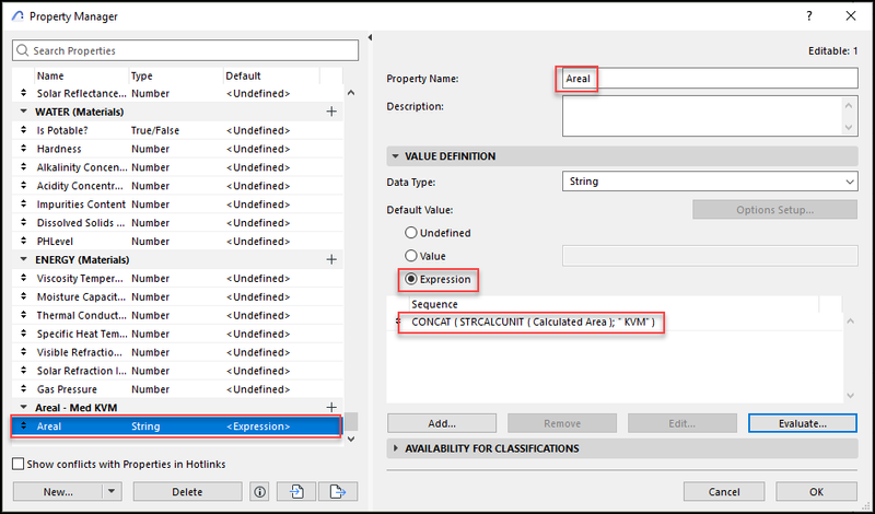

Start off by creating a P_Set, and a property with a data type of String, the name doesn't really matter, just be aware of the fact that the name of the property will be displayed in the zone, In my example, the property's name is Areal: (The name of the property can be changed at any point)
Select Expression,  And make the same expression as you see in the attached image.
Its important to assign the correct value to it (in lack of a better term)
As shown, do this process for both the group, and the property itself.

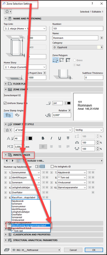

Tag a zone, hit CTRL-T:
You might need to do some trial and error as to how you want your label to look.
Find the part of the settings that look like this, you might have another language. Enter first row, and at the Areal-property you just made. It is important to tick the "Show Classifications and properties", otherwise you will not get the desired outcome.
Do this in both 1:50 and 1:100, and you are, as far as I could tell, pretty much covered regardless of scale.

Yves
It is possible but you will have to make a copy of the zonestamp and its macros
Here is a video where I do it in a few minutes
https://youtu.be/mqhyKB8Ajeo

Unfortunately my scripting abilitys are not quite good enough. I tried following your video but I get stuck when I can't open or save the text "quantity_text_writer".
I sent you a private message with my email adress. Is there any way you can send me the zonestamp you created?
Also; is this new zonestamp compatible with archicad 27? I noticed you created it in 24.

Did this using properties and expressions...
Sufficient?
.Kamelite
Windows 10, Archicad 28
That would definately work! How did you do that in expressions and propertys?

Yves
Hi Malin,

Solution
