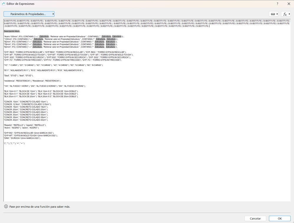

I've been doing some translations using the "SUBSTITUTE" expression, based on a previous expression that takes as values ​​some acronyms from the name of the Composite or Complex Profile, also modeled with walls. The issue is that if I call another "SUBSTITUTE" expression, I get an "Unknown Error" which limits my ability to create a translation database for these acronyms, but I can't find a way to overcome that limit. See images below:
No errors

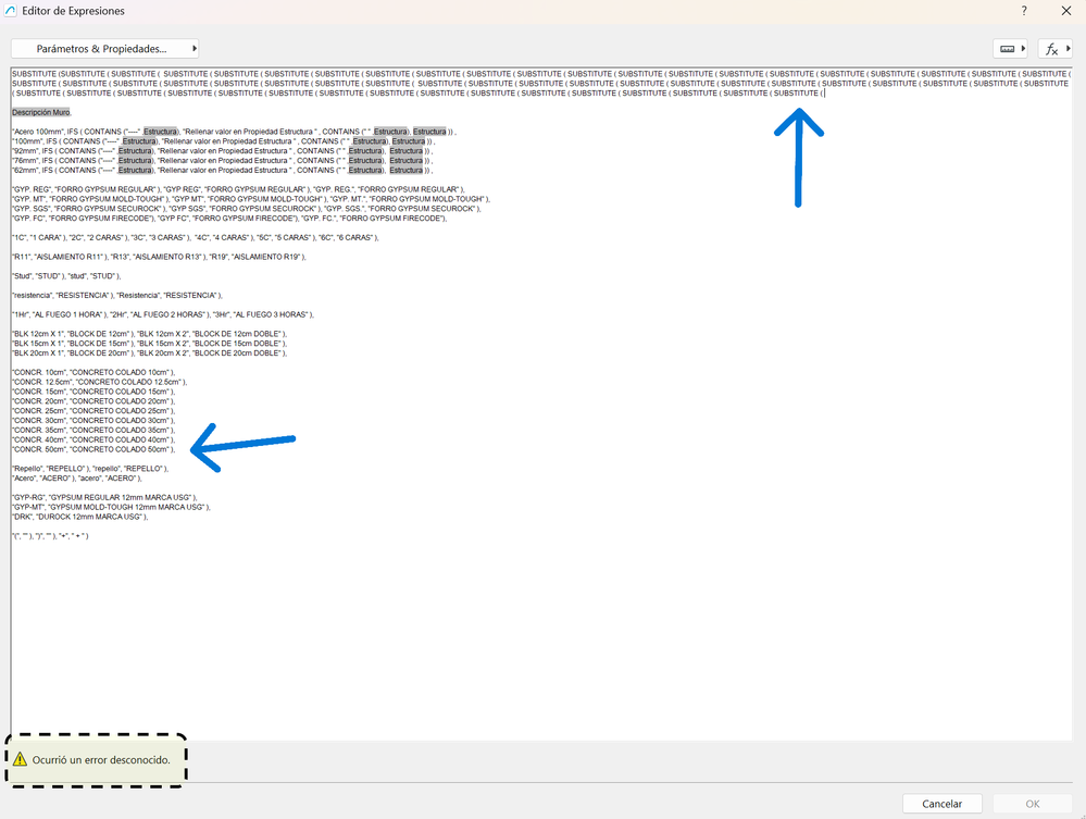

"Unknown Error"

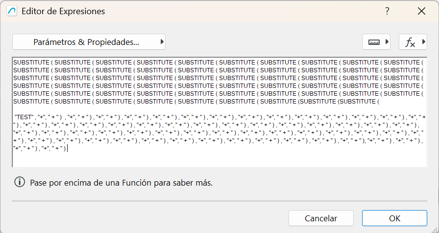

I ran some tests and found that the limit is 59 "SUBSTITUTE" functions, because if I reach 60 functions, I get an unknown error. I'm sharing screenshots below.
59 "SUBSTITUTE"

60 "SUBSTITUTE"

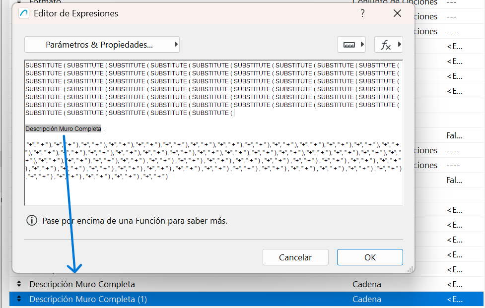

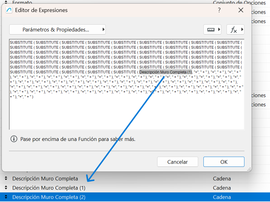

I did the same test calling this property with 59 "SUBSTITUTE" functions, and I can add another 59 functions. I did it three times, and it keeps calling without any problem.

If creating three expressions is a viable route for you, I would recommend that for now. If this is indeed a limitation in Archicad, we will not be able to circumvent it or modify it; only the developers can do that.
I would also recommend that you report this to your local reseller, so they can investigate and confirm if this is a bug or a limitation.
