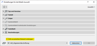

  • While placing your label, check that this method is selected
  • Another way to check if your label is associated to an element is via the label settings. If the highlighted option is not visible = not an associated labelXandros_1-1724930735417.png
  • What ArchiCAD version are you using? I do believe that the possibility of labeling zones was introduced with version 25
