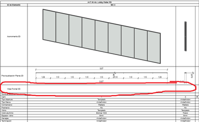

Hi there! I wonder why doesn't show the Front View of my Curtain Wall when asking in the field "3D front view" of the curtain wall, in SCHEME. Does anyone knows how to display it? I am a Latin American User, therefore I use Archicad 26, Spanish version. Thanks your your help!

As far as I know you can't recall the front view in schedule as you would a window/ door.
I think you can follow the steps here to achieve your desired results though: https://support.graphisoft.com/hc/en-us/articles/28065417740817-How-to-show-the-front-view-of-a-Curt...
hope this helps.

Very helpful indeed! I will work on it. Thankyou.
KevinJ
It's a (bad) solution for a problem that should not be ! This curtain wall tool need an update asap ! That should come clean and easy in schedules with door and windows visible on plan and front view or 3D, and possibilities to annotated dimension automatically.
