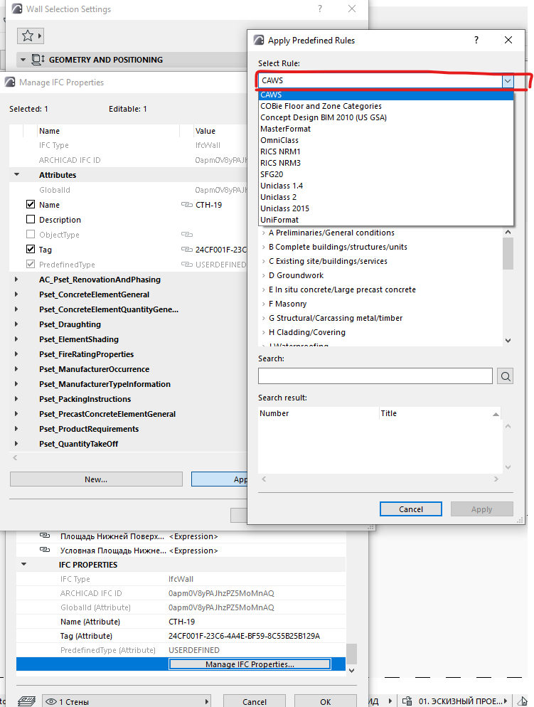

When creating through the Archicad classifier, I will have to manually change everything again manually each time. It is necessary that he read from a .txt file or .xml
Already preinstalled or according to your link do not suit us at allСнимок экрана 2021-09-07 230422.png
Already preinstalled or according to your link do not suit us at allСнимок экрана 2021-09-07 231424.pngСнимок экрана 2021-09-07 230422.png

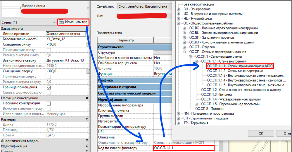

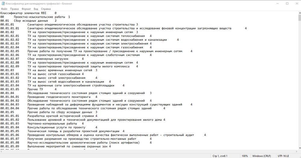

This is the second time I am writing this answer. In the new (stupid) forum, for some reason, the answers disappear after editing them.
And so, when creating the Archicad Classifier, the ability to change at the request of the customer will be very difficult, since he provides us with a .txt or .xml file that they worked (used) in revit. Instead of just loading this file, I will have to redo everything. And this is very time consuming.

I would open the TXT file the client sent me, and also open an Archicad classification XML files.
Then, I would see if there can be some relatively easy way to convert the data in the TXT file into the XML format.
