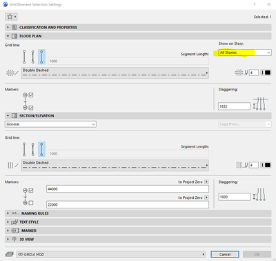

AFAIR when a grid is created in the module file, there is an option to show it on all stories. This will apply when it is in the master file too, as long as the storey structure is the same. It doesn't however apply to the dimensions. The dimensions will only be on the storey they were on in the module file. You will need to dimension the grids individually on each story in the master file. Not ideal I know, especially when you have a high rise building.
Perhaps this is contributing to the issues you're experiencing?

The grid has been set to SHOW ALL STORIES.
The Storey structure IS NOT the same in the module file and master files.

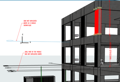

I'm having the same issue. I got the L01 as my mod's origin and placed it above on L02. The L01 mod's layer combination does include the grid (layer turned on). The grid is set as "all stories). From the 3D I can tell that for some reason the grid was not exported with the mod. Is that a " software limitation" or did I miss a setting somewhere in the mod or in the grid? Theoretically, since you can see the grid on every level you don't need one at each storey except when you need to mod things and dimension once...
