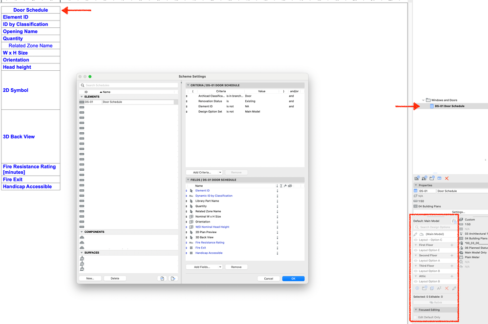

Hey there! I’m having a bit of a challenge. I need to prepare a door schedule, but I’m stuck because all the design options on the schedule section are turned off. Does anyone know how to activate them? I’d really appreciate your help! -- I know if I move all my elements to the Main Model, they will appear on the Schedule, but that’s not a solution since I will lose all the design options that are already in place and I still working on.
Operating system used: Mac Apple Silicon Sequoia 15.6

You'll need to create a Design Option Combination in which the design options you wish to display are visible. Then, create a view for your schedule, and in the view settings, set the Design Option Combination for that view.
