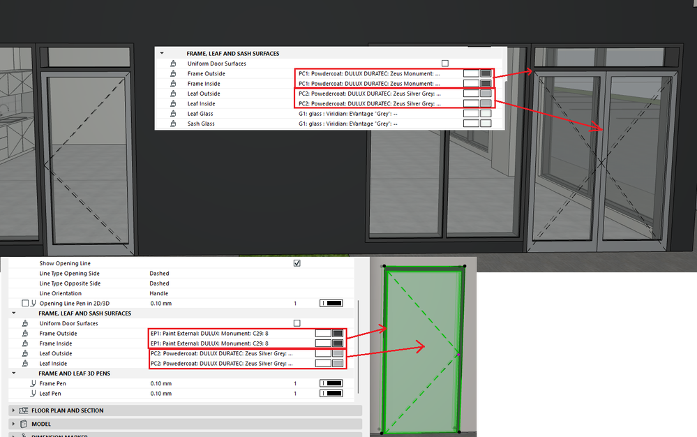

continuing on from the solved IFC Property Mapping & Scheduling from earlier, is there a way to bring in multiple Library Part Parameters (door frame / door leaf /  door grill etc) & let them merge correctly in Schedule?
i have internal & external doors which have different finishes (different colours of powdercoat, different colours of paint etc). a couple of examples below:
with the way the Mapping Rules are set, they prioritise the heirarchy order:

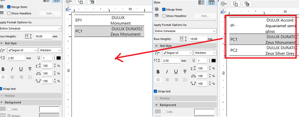

this means i have to create 2 separate schedules -- doing so means that PC1 for a door frame will not be merged in the schedule with PC1 for a door leaf.
is there a way to forego the heirarchy order in the Mapping Rule & let the IFC grab all the data where i point it to? (leaf_mat / frame_mat / ...others)

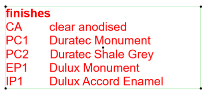

so the schedule can bring in the codes for all internal & external doors, aluminum & solid core all in one schedule so it will say:
(manually typed, which i want to avoid)
