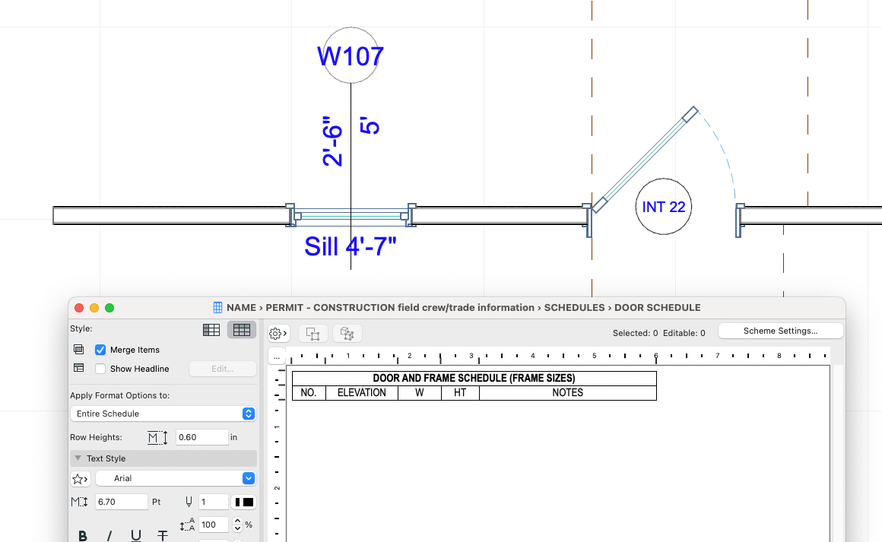

We have a project and we are working on the window and door schedule. Unfortunately these items are not appearing in the schedules. Nothing, Nada.  We have the headers from the units showing but none of the openings appear.

You can definitely delete the last two criteria.
You already defined that the Element Type must be a Door Type, so those last two are redundant.
If that does not help, then I would add each criterion one by one, so you can see which criterion causes the issue.
For example, do the Doors appear in the Schedule if Element Type is All Door Types is your only criterion?
Another thing I am wondering is whether Renovation Filters can have anything to do with this.
@Beth_G ,
Exactly as Laszlo says.
You are setting criteria for Library part name is not 'Empty door' AND Hotlink element is not 'X'.
They probably don't match that criteria.
Remove one or change to OR and see if that helps.
Placing brackets around groups of elements can also help.
So maybe ... (Library part name is not 'Empty door' AND Hotlink element is not 'X')
The criteria is very specific.
