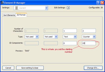

Probably you did this, but:
Go to the ID Format tab. Here is where you set the alphanumeric options and tell it which number to start from.
HTH

Scott Bulmer
Indeed I did that. Something is haywire. I have New & Reset but still get the same results. Thanks for your response!
