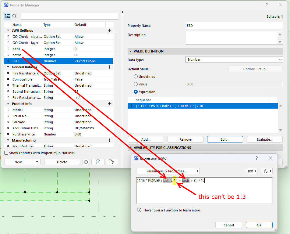

The expression will be exactly as you have shown it here.
I am assuming the (Baths)1.3 means bathe to the power of 1.3
Mathematically I would write this as (Baths)^1.3
So in my case because the properties are in a group called 'JWH Settings' ....
( 1.15 * ( {Property:JWH Settings/baths} ) ^ 1.3 + {Property:JWH Settings/beds} + 3 ) / 10
The problem is in the property expression, it will not allow the power to be a decimal number.
It must be a whole number.
I see there is a 'POWER' mathematical function, but this does not allow decimal power value either.
I am not sure how you would get around this.
Any mathematical geniuses out there?

Can you just put a division in brackets? ie. (Baths)^(13/10)
| Win11 | i9 10850K | 64GB | RX6600 | Win11 | 7800X3D | 32GB | RTX5070TI |
yesterday
Nope, I tried that.
The 13/10 still equates to a decimal value which it doesn't like.

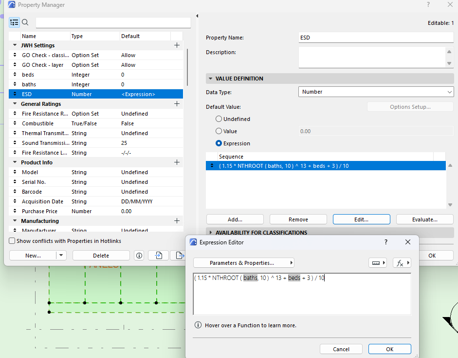

There is a "nth root" function. Try (nthroot(bath,10))^13
yesterday
That seems to work, thanks @Lingwisyer .
For 2 baths and 3 beds I get 0.88.
Would that be correct @Mikey_B ?
yesterday
Barry,
Yes, that looks correct. The county online calculator rounds up to 0.9. I'm thinking I can control the decimal places by adjusting the Calculation Units for the schedule?

There is a rounding function in the property expressions.
You just need to put that formula in the rounding function.
ROUND ( insert_formula_here, 1 )
