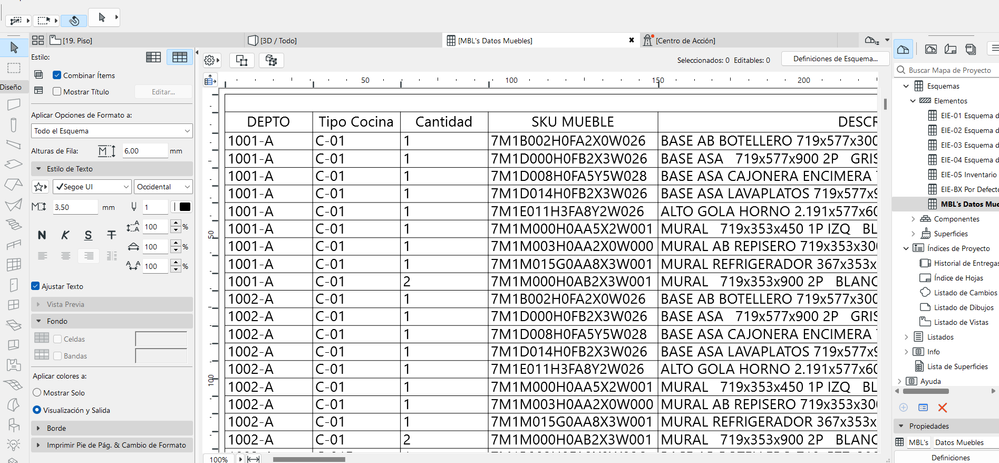

I have a schematic in Archicad 27 which I need to export so that an internal application can use it but I need to export it with a Python script or some addon. Can someone guide me? Attached is an image of what I need to export so that the idea is understood.

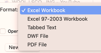

If you are just learning Archicad, Python is the absolutely LAST thing to learn/ask about šŸ™‚
With your schedule displayed as in your screenshot, you can save it as a tab delimited data file or an Excel worksheet simply with File > Save As and selecting the desired format:

When you have many schedules that you want to export for use in external software, Publisher is more convenient as you can include in a publisher set every required schedule and one click will produce the output files.  This example has 2 schedules being published as Excel files:
