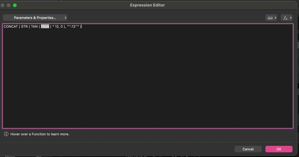

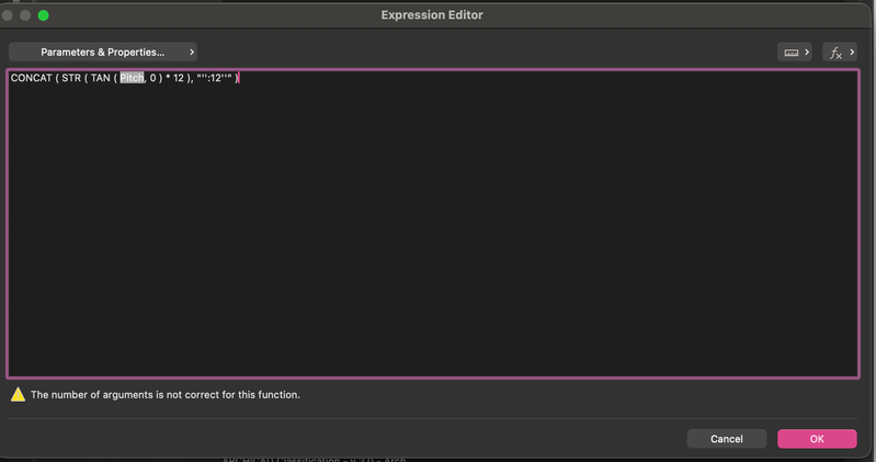

I've got my properties set up for a company roof tag. The elements work perfect UNTIL I try to delete the decimals from the string conversion, it thinks I want to multiple by 0 and so all of my slopes are coming out 0:12. can someone please help me figure out what is wrong here? I've also changed it to a ; with same errors.
the code that works is
CONCAT (STR (TAN (PITCH) * 12), '':12''"
I should just be able to add (PITCH, 0) so that there are zero decimal points, but when I do that it tells me there are an unexpected number of expressions.
Please help!

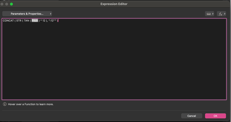

This Expression of yours
is incorrect because
1. After the comma (,) you have two single quotes,
2. At the end, there are three quotes: two single quotes and then a double quote.
So, the text :12 is surrounded by two single quotes on both sides instead of a double quote.
You should have only 1 single quote, then 1 double quote, and it should have a closing parethesis (like on the screenshot).
Something like this:
CONCAT ( STR ( TAN ( Pitch ) * 12 ), ":12'" )
Or, if you want to specify deciman places:
CONCAT ( STR ( TAN ( Pitch ) * 12, 4 ), ":12'" )

JKL
Thank you Laszlo, those are actually there on purpose and not effecting the expression-it is double ' to show " in the tag I am creating. So it is ' ' ". This is built into all of my expressions and this is the only one that is having trouble. It is when adding in the decimal placement. It looks like from your example above, I need to add it after the multiplication. I'll try that and see if it works!
Thank you!

JKL
Yes! That was exactly it. I didn't realize that decimal indicator would go after the expression! Beautiful!

If you want to write a
(double quote) character with a Property Expression, you can place a backslash in front of it like this:
and then Archicad will know that it is not the start or end of a string, but a literal double quote character.
So, if you use the following for your Expression:
CONCAT ( STR ( TAN ( Pitch ) * 12, 0 ), "\":12\"" )
you will get the desired result. For example:
4":12"
