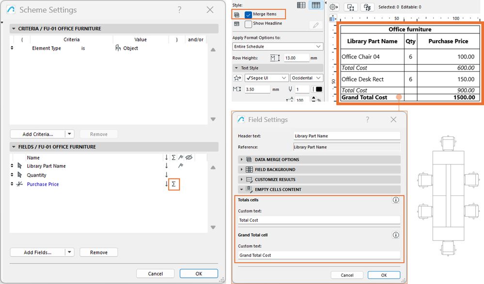

I want to work only with schedules in Archicad without having to export them to Excel. I need to be able to read the budget price for a piece of furniture and see what the total cost will be for all "office chairs" (budget price per unit × quantity).
I would like to create an Expression that can multiply the total quantity by the budget price directly in the schedules. However, I cannot find quantity in the Expression Editor.
Does anyone have a suggestion for a formula?

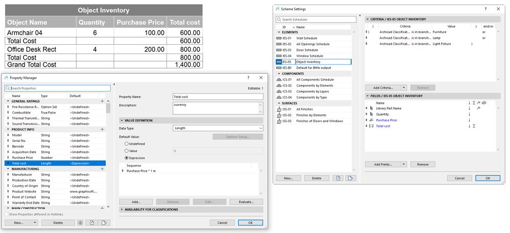

There is a trick you can use to schedule total cost of merged items in schedules.
It is based on the fact that the values of Properties with the "Number" Data Type are not summed in the generated schedule when items are merged, while the values of Properties with the "Length" Data Type are summed.
So, you can create a new Expression-base Property called "Total Cost", and it expression will be
Purchase Price * 1 m (you multiple the Purchase Price by 1 meter, which will preserve the value while also converting a "Number" Data Type to a "Length" Data Type.)
Then, when this Total Cost Property is scheduled it will display the total cost of the merged items.
The only drawback is that if you SUM the Total Cost field in the Schedule, both Total and Grand Total rows will be displayed. Unfortunately, it is not possible to display only a Grand Total row and no Total rows, so you will have this redundancy if you use this method.

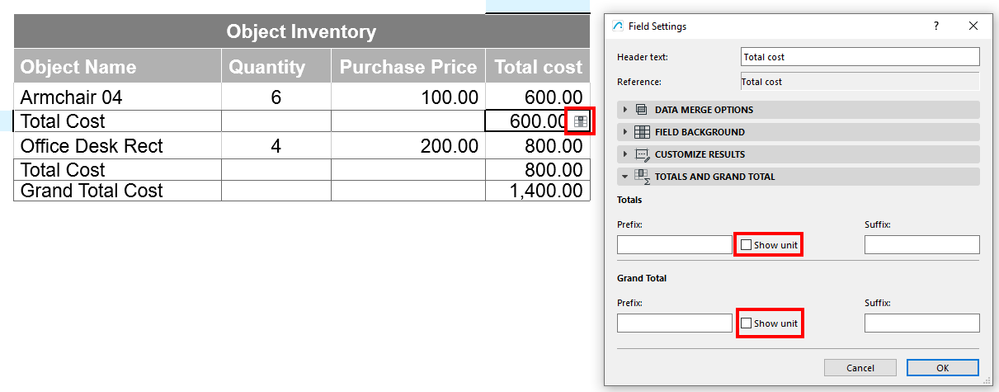

One additional thing:
You need to click the little settings button in one of the Total/Grand Total fields and uncheck the "Show unit" checkboxes, otherwise m for meter will be shown in these fields, since the Total Cost Property is of "Length" Data Type.
