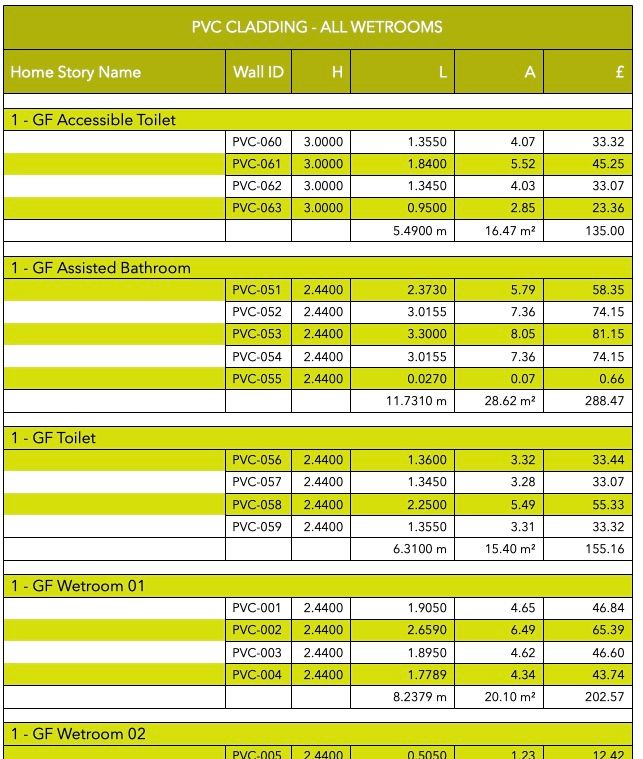

I've set up a Surfaces Schedule to list the surface areas of these PVC walls. It's working fine but it's listing all the surface area and wall length information in one single table.
Is it possible to also track information from the Zone in which each wall is located in the project? So I can then group by Wetroom and make the table more easily readable?

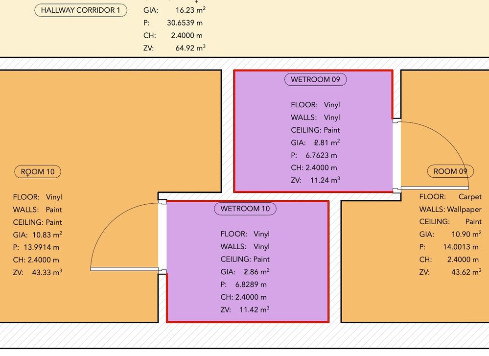

Hi Laszlo, here are screenshots of part of the plan and the corresponding PVC sheets schedule. The red lines are 1cm-thick walls, representing the PVC cladding internally in each wetroom:
Like I said, job done for now; but I resorted to manually tagging the Wall elements representing the PVC sheets of one room by a parameter I set up. Not too tedious, but it is manual work so there is room for error in reporting.

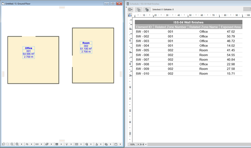

If you set the Wall's Relation to Zones field to "No Effect on Zones", then the Zone will not consider those PVC Walls as Zone boundary.
Then, you can use the Related Zone Number and Related Zone Name parameters in the Surface Schedule to get the info you need.
