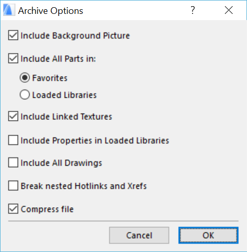

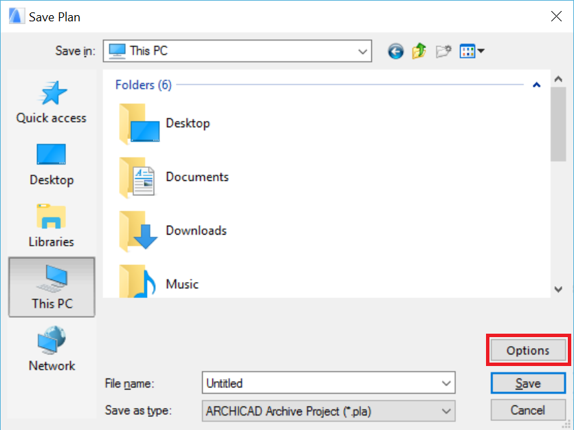

If you save the project in .pla format, it stores only the library parts used in the project by default. In the Save as... dialog under "Options" you can also set further content to be saved with the project:
Please note that included files can largely increase the project's file size!

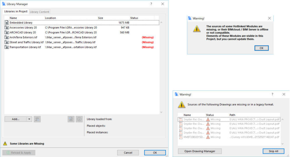

While you are opening the ARCHICAD project on the other computer, warnings will inform you about the missing reference files:
  1. Missing Linked Libraries
  2. Missing Hotlinks
  3. Missing sources of Drawings

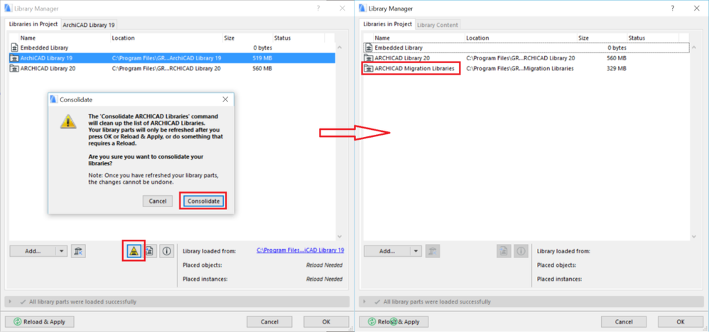

    • The default ARCHICAD Library of the current ARCHICAD version (e.g. ARCHICAD Library 20 in ARCHICAD 20) can be found automatically.
    • ARCHICAD libraries from previous ARCHICAD versions that are already loaded need to be updated: select the ARCHICAD Library item on the "Libraries in Project" tab page of Library Manager. Clicking on the yellow triangle under the list of libraries you can consolidate your ARCHICAD libraries easily. Consolidating ARCHICAD libraries is highly recommended, because it replaces old ARCHICAD libraries with the latest one and also loads the requisite Migration Libraries so that you still have access any now-obsolete library parts you may be using.

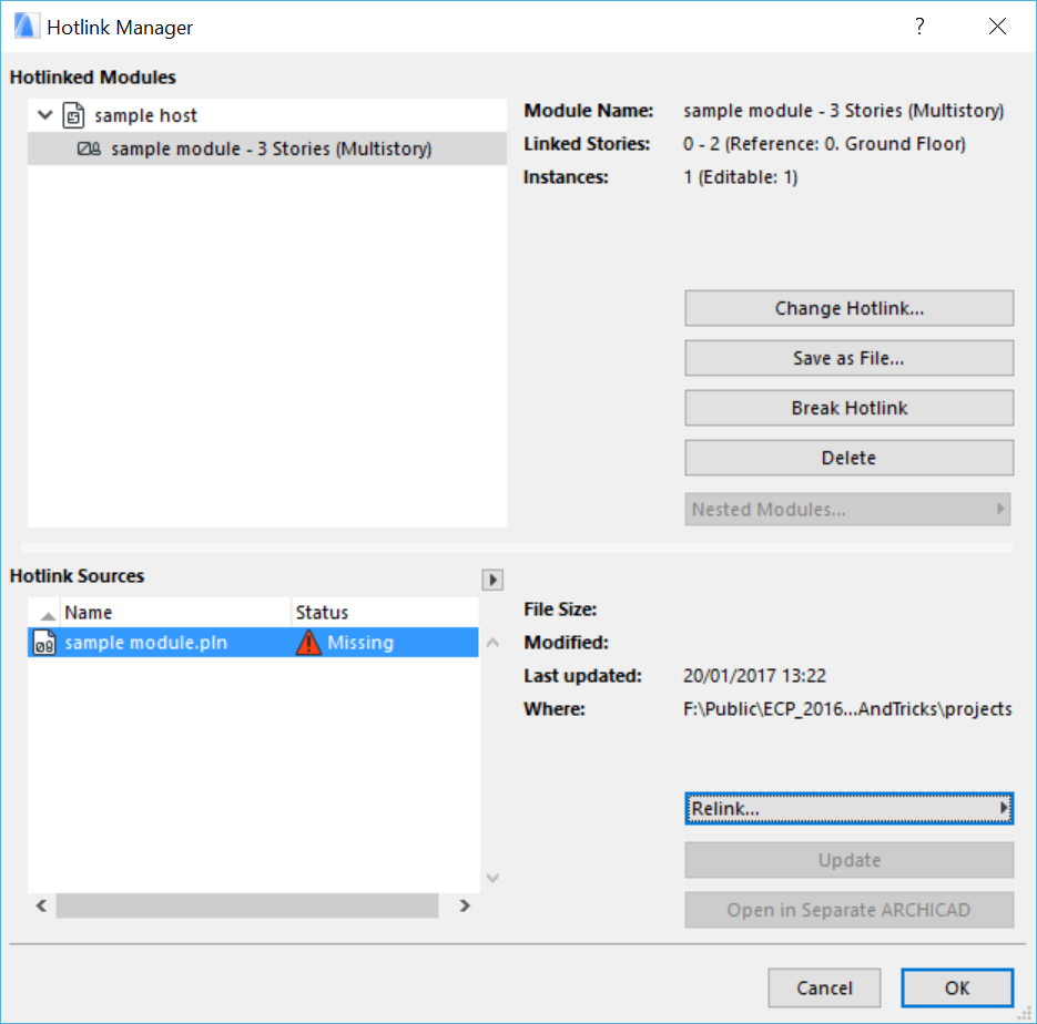

To relocate the missing hotlinks, please open the File/ External Content/ Hotlink Manager dialog.
  • Restoring Missing Hotlinks
    • The hotlink modules are actual elements, not just references to them. If the connection to the hotlinked module file is lost, the modules cannot be updated. To recreate a live Hotlink to a module, select the affected project in the Hotlink Manager dialog and relink with the new Hotlink Source manually.

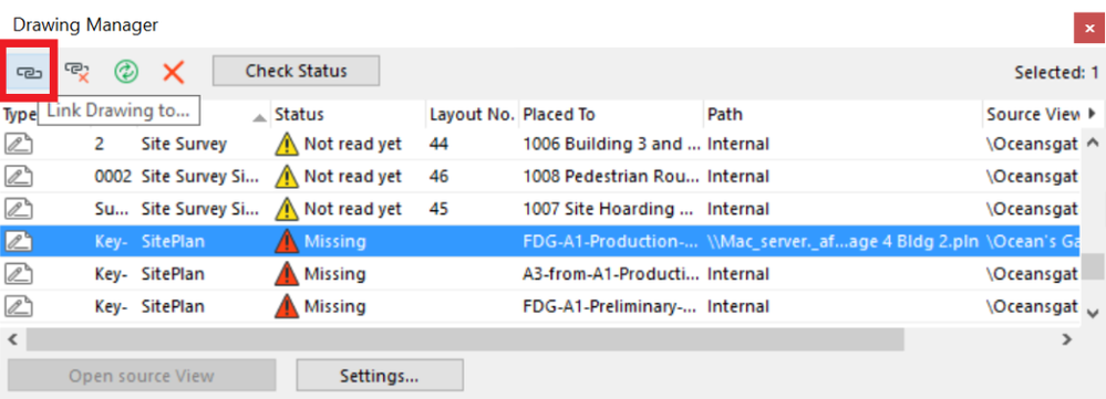

To relocate the missing drawing references, please open the File/ External Content/ Drawing Manager dialog.
  • Link Drawings from the Same Source Folder
    • If the missing drawings of the project are located in the same folder on the new computer, it is very easy to relink them. Select the missing drawings in the Drawing Manager and click on the chain icon ("Link Drawing to") at the left corner of the dialog. If several items are selected in the dialog, it allows you to link the drawings to an external source folder.
  • Link Drawings to the Source File one-by-one
    • If the missing drawings are located in different source folders, you need to relink them with the chain button ("Link Drawing to...") one-by-one.
