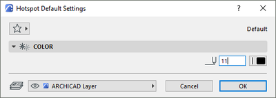

I was just looking in the tool settings and saw there was no option to set the reno status in the Properties, so assumed they do not have any.
And there is nothing in the Work Environment to show hotspot properties or reno status in the tool settings or info box.
However you can set it with the renovation pallet.
