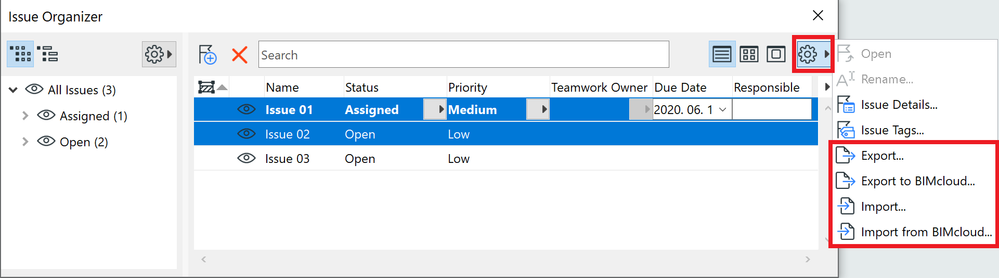

You can export the issues from Issue Organizer. You can decide to export the entire list of issues, but you can also select only some of them to be exported.

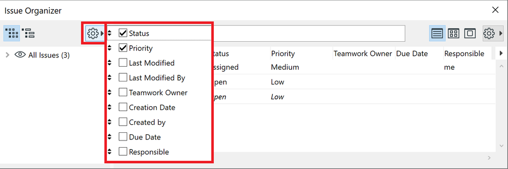

On the left side of the Issue Organizer you can sort the issues by the issue tags, such as: Status, Priority, Teamwork Owner, dates of creation and modification, and so on. Use the Additional Settings button on the left side of the dialog for this purpose.
Use the Additional Settings button on the right side of the dialog. It lets you access the commands that are related to the export and import process.
