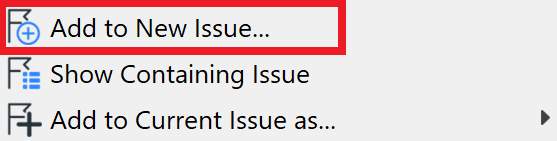

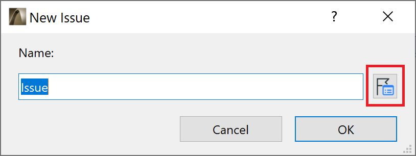

When the elements are selected, right-click and select the Add to New Issue... command. The New Issue dialog pops up. Name the issue in the dialog. Press the button with the flag icon on the rigth to access and edit further details of the issue, such as:
  • status (open, assigned, resolved, closed)
  • priority (low, medium, high, urgent)
  • due date
  • labels
The elements of the new issue will be highlighted in the model in blue.
If an existing issue is currently open in the Issue Manager, you can add the new issue as a response to the current one.
You can check if the element you selected is already part of an issue by using the Show Containing Issue command in the context menu. This command is only active if the element is part of an issue. The command opens up the Issue Organizer and the issue that contains the selected element will be highlighted.

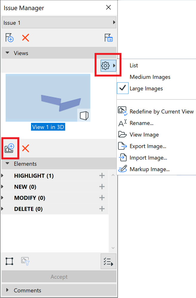

Issue Manager

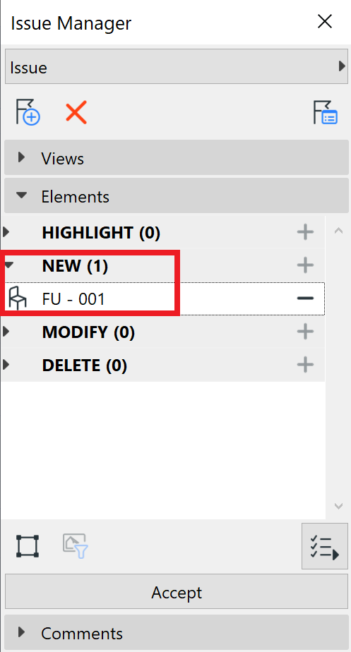

The Issue Manager palette is for the controls of managing a single, selected Issue, with the following functions:
  • Add views (images), or import/export images
  • Manage Issue elements (categorize them as Highlight, New, Modify or Delete)
  • Accept the suggestions in the Issue (e.g. new or modified elements)
  • Add optional Comments.
To select an issue you want to edit, click on the button at the top of the palette. This opens the Issue Organizer for the time of selection only.
To open Issue Manager do one of these:
  • Use its toolbar icon
  • Double-click a listed Issue in Issue Organizer
  • Document > Issue Manager
  • Window > Palettes > Issue Manager
To switch to a different issue in the Issue Manager, click on the issue name in the list at the top of the palette. This click opens up the Issue Organizer palette, where you can select another issue by double-clicking on its name in the list.
Add Views to an Issue
Add views to issues to make it clear where they are in the model. You can export and import images that belong to views. You can also mark them up in your computer's default image editor application.

By default, the elements added to a new issue are shown as Highlight in the Issue Manager and are highlighted in the model.
You can suggest changes related to the issue's elements by moving them to a different type of the issue:
  • new
  • modify or
  • delete
Using these issue types, you can suggest the creation, modification or deletion of the marked element(s).
To do so, click on one of the plus buttons in the Elements section of Issue Manager.
Elements of different issue types are shown in different colors in the model.

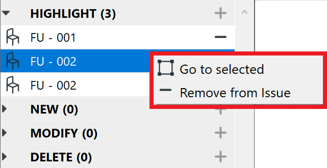

Further actions you can perform on a selected element by using the context menu of the selected item in the Issue Manager:
  • You can select and show the selected item on the floor plan or in the 3D window by using the Go to selected command.
  • You can remove the element from the issue.

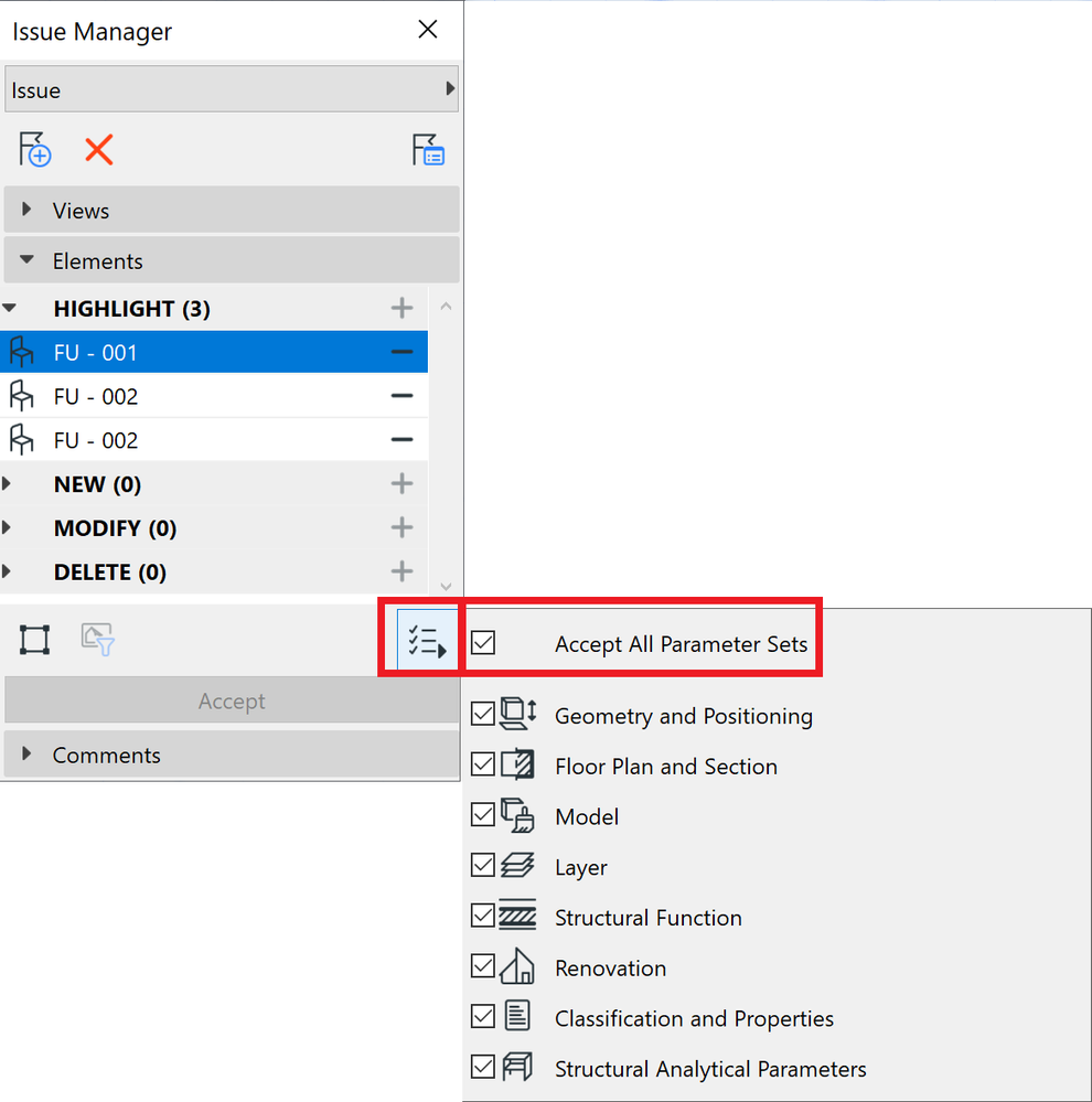

Accept Suggested Design Changes
The suggested changes are not carried out in the project until the issue is accepted. New elements become parts of the project, modify type elements replace the prevoius instances, delete type elements are removed from the model.
You can accept the suggested changes for each element contained in the issue by pressing the Accept button at the bottom of the palette. After this, the elements' status will be Highlight.
You can also accept the issue only partially. Within an element, you can, for example, accept the change of the geometry but not the changed classification. You can select what parameter sets of the element to accept by using the Parameter Sets button in the Issue Manager.
