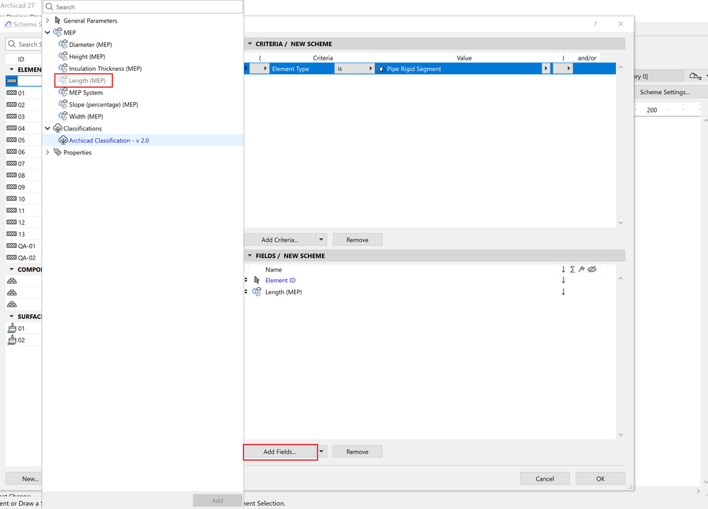

Mscott
In AC27 Update 2 you can schedule the length of MEP elements see screenshot attached for reference.

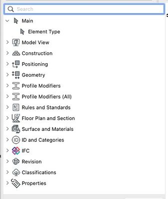

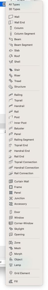

I do not have MET objects in the Schedules even if I have MEP license. Can you help, please?

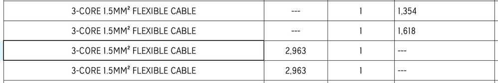

Hi again,
It is not working as expected. It shows only a horizontal length, not a total one.
Attached is a screenshot with two balustrades imitating wires with the total length
and two with MEP length. I need a parameter of the pipes in total:
horizontal, vertical and bends as any underground or underfloor heating flexi pipes
in the building are a one-piece, ordered in linear meters and as one element in 3D.
Maybe try to use code from the balustrade to work it out as it works and gives me
real lengths e.g. for UFH.
Thanks
