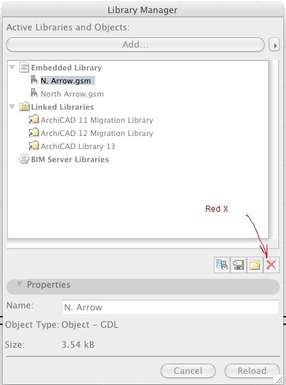

Thank you for your reply. I have moved my Custom Objects folder into AC13 Library and updated the library in my Template so that only the following libraries are in it:
ArchiCAD 11 Migration Library
ArchiCAD 12 Migration Library
ArchiCAD Library 13
BIM Server Libraries
There is also an Embedded Library that contains 2 North Arrows that I drew and saved as 2D GDLs. I have moved copies of these into my AC 13 Library, so now I am getting a message about duplicates. I cant seem to remove these items from the embedded libraries. Any suggestions?

Matthew, thank you for your input. I have attached a screen grab of a library manager window that has not been fully updated yet. I drew an arrow to point out the "red X" that I spoke of. As you can see, I have highlighted one of my North Arrow objects. If it were not highlighted the red x would be grayed out.

Legacy parts would be those from the previous libraries. Embedding them will allow you to unload the older migration libraries.
The red X is to remove the selected library. If there is no selection the X is grayed out.
