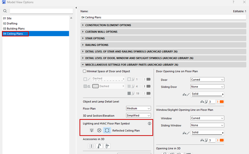

Create a view from your schedule, where 2D Plan Preview field is added and choose a Model View Option where RCP is activated (Ex. Ceiling Plans) in Miscellaneous...> Lighting and HVAC Floor Plan Symbol.

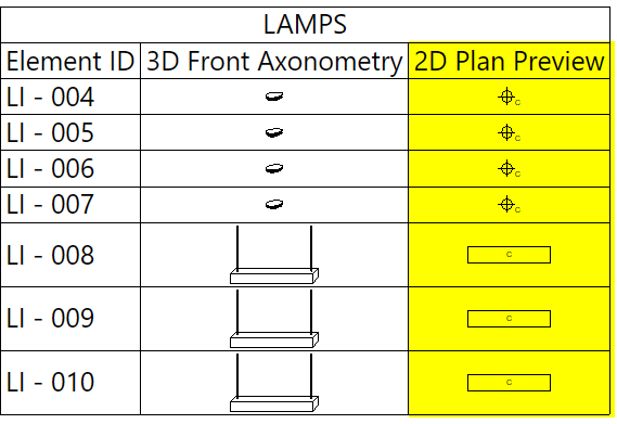

Ricardo, thanks for the reply.  I already had it set up that way, but I figured out that the 2D representation for each light has to be set NOT to "by MVO."  They are showing up now.
Next question... can I change what the RCP symbol looks like?  For example, for some reason both the pendant light and recessed spot light use the same RCP symbol, so one of them needs to change otherwise there's no point in scheduling these interactively.  In addition, I'd like to be able to use a symbol somewhat close to what my engineer is using... as another example, the pendant light and the surface light in their 'electrical' symbols are reversed from what's typical here.
