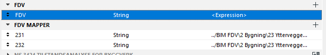

I kind of fixed it!
where the property that's extract the first number of the layer is:
And the new 2 property groups are:
Expression:
IFS ( {Property:NS 3451 BYGNINGSDELSTABELL/NS 3451 (3-sifret)} = "231"; {Property:FDV MAPPER/231}; {Property:NS 3451 BYGNINGSDELSTABELL/NS 3451 (3-sifret)} = "232"; {Property:FDV MAPPER/232} )
