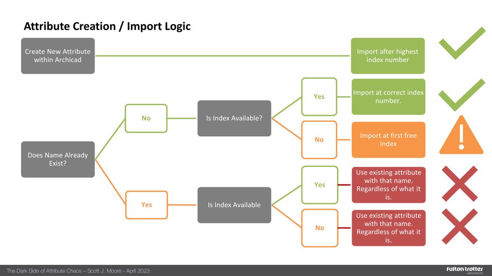

I just tested this.
When you copy and paste from another file, if the attribute number exists already, then it does not update anything, it just uses the existing attribute.
If it is a new attribute number, then it creates a new attribute with that number - it does not create an attribute with the highest number.
So you will have no way of knowing that a new attribute has been added except by comparing it to your template.

scottjm
Mentor
Can confirm as of AC27 4030 attributes will import themselves outside of a folder, even if there where in a folder in the file they were copied from.
I'm pretty sure this is an unintentional 'feature' but I find it very helpful.
This slide from my attributes webinar seemed to be the thing most people latched on to, makes it easy to see how messed up attribute pollution is.
