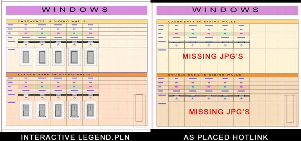

Based on an Eric Bobrow Aecbytes article; I've created an interactive legend in a regular pln file. I have placed that pln file into my target project file as a hot linked module file.
Problem:
1) No placed drawings (actually jpg's) in Interactive Legend file show up on HLM in the target project file.
I changed the drawing selection settings to "store drawing in project file", still no bananas.
Thanks,
Snap

The jpg images are external drawings via >File >External Content. My "legend" is just a plain simple .pln file that I HLM into whatever file I'm working on to provide me with "visual shortcuts" to my usual stuff.
The actual working part of the legend, is a plan view wall element with a window in it, that is what I pick up (eyedropper) the attributes from. The missing image is just window dressing (ahem) to make it easier to see which window I am picking up. Perhaps I completely misunderstood what Bobrow was talking about and went down a different path.

The interactive legend does not use a .jpg image for the elevation views. These are merely lines and fills taking from an ArchiCAD generated elevation then placed in plan along side the appropriate window plan view (which is live).

OK, I think this is a limitation.
I placed a bitmap using the Figure Tool and that goes through to the host file as part of the Hotlinked Module.
This may have to do with the fact that a Figure becomes part of the Project File, while stuff placed with the Drawing Tool is an external reference and maybe this is why it can't appear in the host file.
