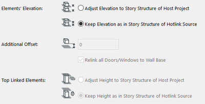

are you linking the saved modules to a new file? if yes have you tried this settings?

Well... after a few weird exports yesterday, it works properly this morning...
I am selecting the module in 3D, isolating selection, then saving selection as module. I would get if extra stories were included, but the fact the the entire story structure was shifted messed up all of the stored story heights. Anyway, hopefully that was a one off event.

Ah. It would appear that when saving a Module from the 3D window, the Homestory becomes which ever Plan Story you were in last. Good to know. Hopefully I will remember that...
I have also realised that using negative stories for modules is not very suitable if they are multistorey unless you leave extra placeholder storeys to accommodate any story structure changes. Story, storey, stories, storeys, storied, storeyed...
