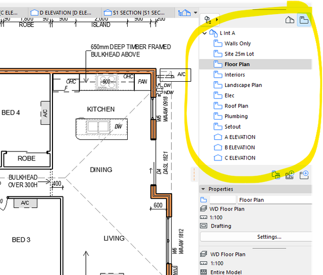

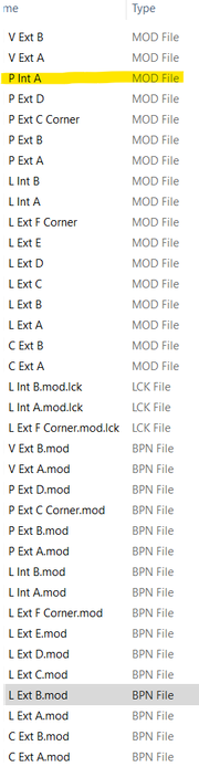

Hi all,
My first screenshot shows all the .mods I have created, along with automatically created .bpn files (except for the highlighted 'P Int A' mod which triggered my post).
The second screenshot is when I freshly open the .mod - those working views I created and are still there and allow me to easily edit the .mod, save it and then update my master .pln file.
I'm gathering from this discussion that this is not possible with v27 which is a shame as it makes life so much easier when I'm updating so many .mods in a file 120 dwellings strong!

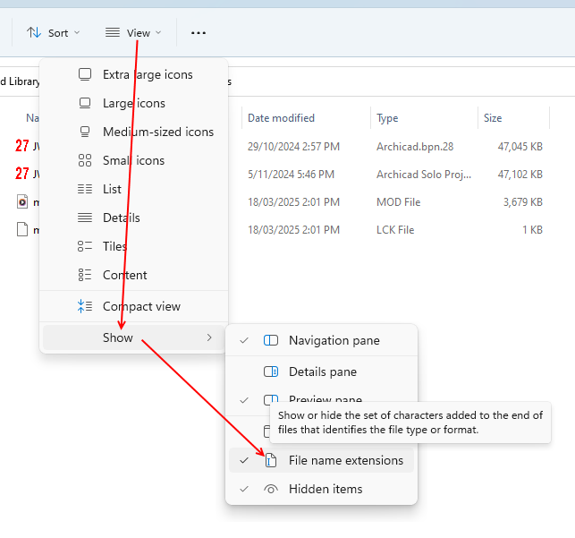

You are doing something out of the ordinary.
Your file list shows a file called "L Ext B.MOD" but the file type is BPN - that is not possible.
But I see you are not showing the file extension for the files, and the '.MOD' is not the file extension, but is part of the name.
Turn the file extensions on in your file browser settings.
You should see the file name is "L Ext B.MOD.BPN" ?
I think what may be happening is you are opening a file and then doing "Save As" and changing to a .MOD file type.
This is fine, but the file you still have open is the .PLN.
So if you just hit 'Save" it will create a .BPN of that PLN file that is open.
You are not re-saving the MOD file if you do this.
The only way to edit and save the MOD file is to actually open that file.
Then when you do save it, it will not create a BPN file.
And the views for that MOD file will be empty (you are showing layouts in your image - not views).
