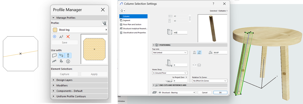

I need a morph as a beam or column because
For example I need to do the slanted legs of the certain stool with chamfered edges. First will use the slanted column then I convert the column to morphs so that I can chamfer the edges of that column
So when I convert that column to morphs I loose the listing parameters like lengths and width of that column I changed into a morph. So to get these parameters may be I should classify that morph into a column again.

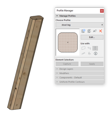

You can classify a morph as a beam or a column, but it will never be a beam or column, it is still a morph.
You can use a complex profile for the column.
This will allow you to chamfer fillet the corners.
Unfortunately you will see lines for the chamfer fillet and at small sizes the radius will be very segmented.
Edit: with a chamfer you will want to see the edge lines.
With a fillet you won't see nice round curves and you will see the edges of the curves as they blend into the straight surface (which you probably don't want).

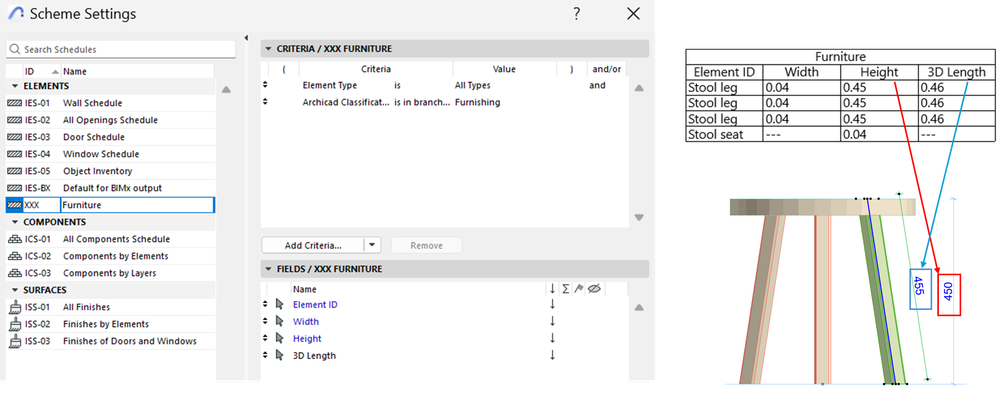

Hi @Cardiac
As @Barry Kelly said, you can create a complex profile and schedule its dimensions. Just a tip for slanted columns: use 3D Length instead of Heigth. See example below.
