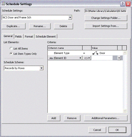

Greetings,
Does anyone know how to exclude doors with a blank ID number in the NCS Door and Frame Sch in ArchiCAD 8.1.
Cheers,
Matt

In the "Calculate/InteractiveSchedule/Settings..." dialog "Add" the "Element ID" to the Criterion Name list and select "<>" and leave the field blank. Refer to the attached screenshot.
