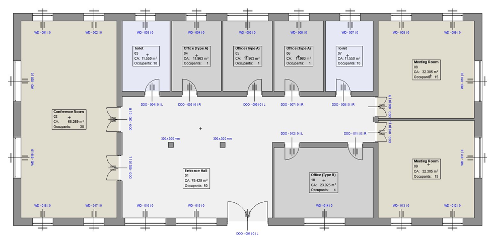

In the example below we will test if the designed room area meets the occupancy criteria defined by the room function. This value varies between certain limits depending on the activities taking place in the room. The maximum capacity of a room (e.g. the maximum number of accommodatable occupants) can be calculated by dividing the floor plan area of the room by the minimum acceptable floor plan area per occupant value. Finally, the design can be validated by comparing the planned number of occupants against the maximum capacity of the room. Based on the design requirements we set desired number of occupants for each zone at Classification and Properties. These values are shown on the zone stamps as well.

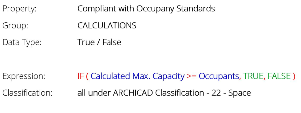

  • The Occupancy Standard Compliance compares the planned occupancy load with the maximum capacity allowed by the regulations and provides a clear feedback in form of a Boolean values: the value is set to TRUE only if the zone is compliant with the standards (eg. the calculated capacity of the zone is equal or bigger than the planned number of occupants).

  • The Occupancy Standard Compliance in the last column compares the planned number of Occupants against the Calculated Max. Capacity and returns True only if the former is smaller than or equal with the latter, otherwise the returned value is False.
Display results on Zone Stamps
The calculated results can be indicated on Zone Stamps as well:

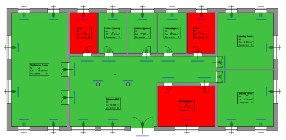

Apply Graphic Override to visualize the result
Graphical Overrides provide instant visual feedback revealing design problems and compliance issues. It is very easy to define a criterion for Graphic Override Rules in ARCHICAD based values of expression-based properties. The criteria in this example is based on the Occupancy Standard Compliance Boolean property. Separate rules have been defined for zones which proved to be compliant (green) and for zones which failed on the compliance test (red) at Document > Graphic Overrides > Graphic Override Rules.
