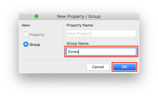

2. Click the New button to the New Property / Group dialogue box.
3. In the New Property / Group dialogue box, select Group, enter the Group Name and click OK.

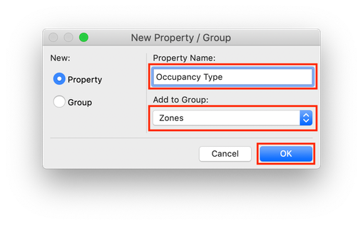

4. Click the New button to open the New Property / Group dialogue box.
5. In the New Property / Group dialogue box, select Property, enter "Occupancy Type" for Property Name, set Add to Group to the group that was just created and click OK.

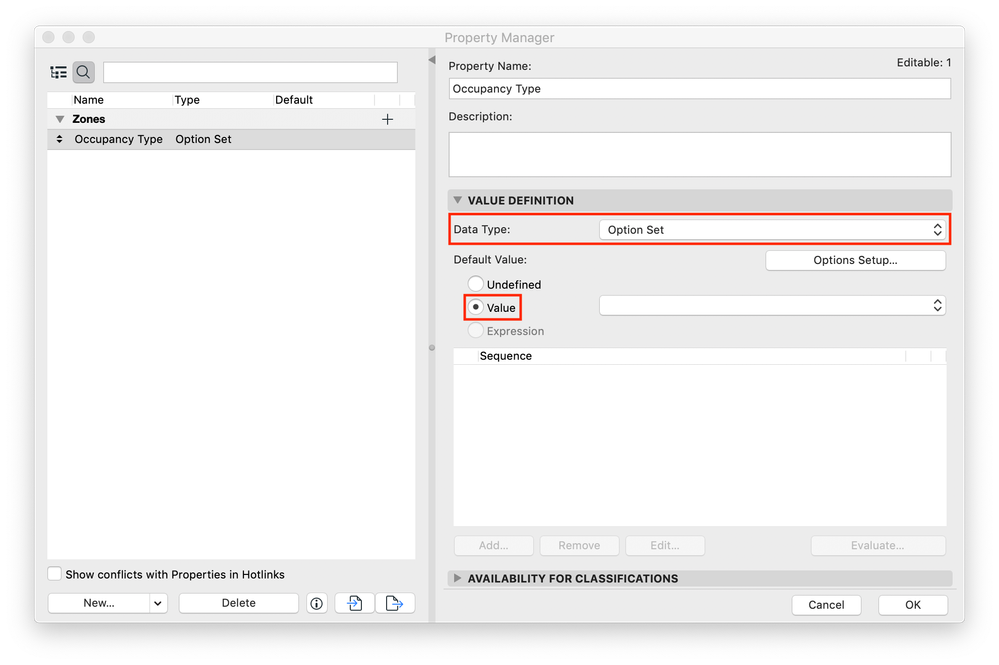

6. Select the Occupancy Type property and under the Value Definition tab make sure that Data Type is set to Option Set and Default Value is set to Value. Once Value is selected, the Options Setup dialogue will automatically open. This dialogue box can also be accessed by clicking the Options Setup... button.
7. Click the Add button to create a list of occupancy types. The name should include a descriptor (ex. Library), followed by a separating character (ex. | or /), followed by the area required in the space per person. Once all values have been created, click OK.

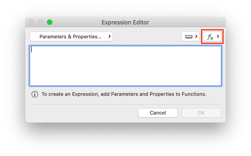

10. Select the newly created Occupancy Load property and under the Value Definition tab make sure that Data Type is set to Integer and Default Value is set to Expression. Once Expression is selected, the Expression Editor dialogue will automatically open. This dialogue box can also be accessed by clicking the Add... button.
wp-content_uploads_2016_06_Info_18x18.png NOTE: The expression in this property will extract the numeric value from the title of Occupancy Type property.

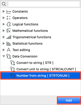

11. In the Expression Editor dialogue box, click the Operators & Functions button.
12. In the pull down menu, under Data conversion, select Number from string [ STRTONUM ] and click Add.
wp-content_uploads_2016_06_Info_18x18.png NOTE: This function converts all text to numeric data. This numeric information can then be used in equations. All numbers in fields that also include text will be considered text until this function is used. In this case, the area requirements in the occupancy type titles will be converted to usable numbers.

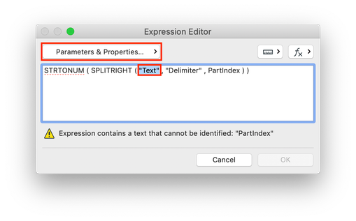

13. Select "Text" (including the quotation marks) and click the Operators & Functions button.

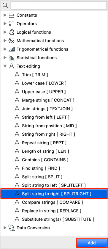

14. In the pull down menu, under Text editing, select Split string to right [ SPLITRIGHT ] and click Add.
wp-content_uploads_2016_06_Info_18x18.png NOTE: The text in the Occupancy Type property value options must be removed before the numeric data can be converted to usable numbers. The SPLITRIGHT command discards the first text part of the title.

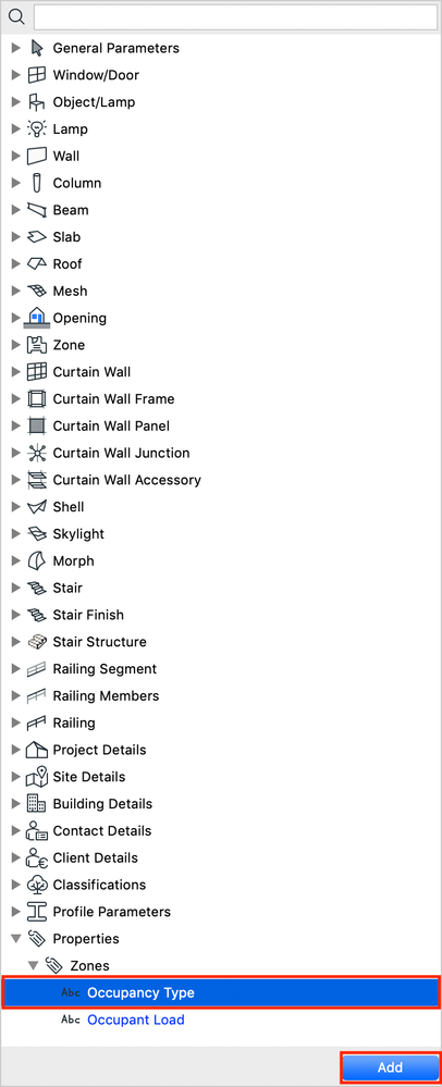

15. Select "Text" (including the quotation marks) and click the Parameters & Properties... button.
16. In the pulldown menu, under the Properties > Zones tab, select Occupancy Type and click Add.

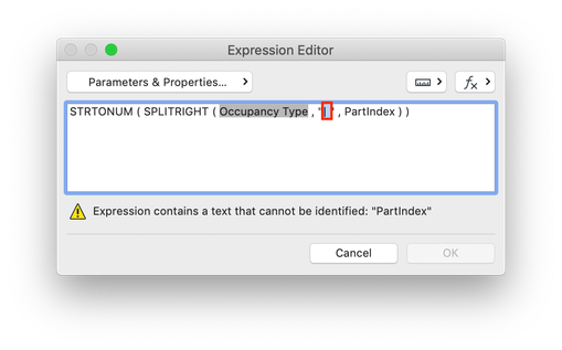

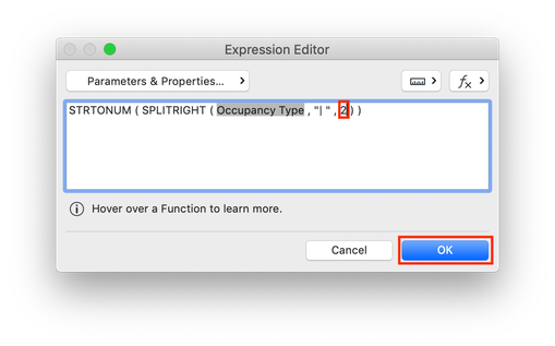

17. Select and delete Delimiter (DO NOT include the quotation marks) and enter the trimming character and the space that follows it "| ".
18. Select and delete PartIndex, enter "2" and click OK.

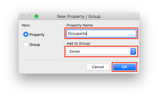

19. Back in the Property Manager dialogue box, click the New button to open the New Property / Group dialogue box.
20. In the New Property / Group dialogue box, select Property, enter "Occupants" for Property Name, set Add to Group to the same group as in previous steps and click OK.

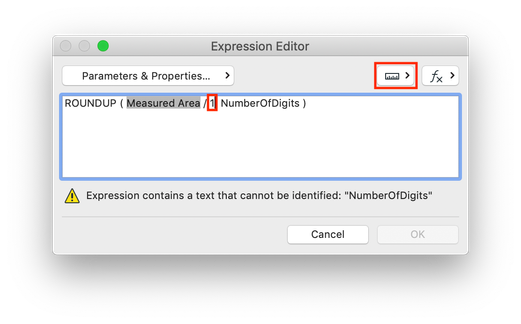

21. Select the newly created Occupants property and under the Value Definition tab make sure that Data Type is set to Integer and Default Value is set to Expression. Once Expression is selected, the Expression Editor dialogue will automatically open. This dialogue box can also be accessed by clicking the Add... button.

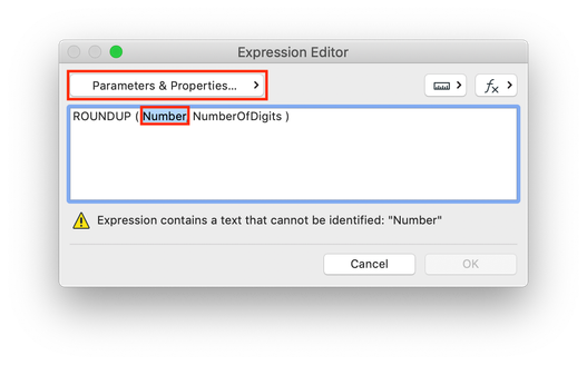

22. In the Expression Editor dialogue box, click the Operators & Functions button.
23. In the pull down menu, under Mathematical functions, select Round up [ ROUNDUP ] and click Add.
wp-content_uploads_2016_06_Info_18x18.png NOTE: This will take the resulting value and round it up to the nearest integer.

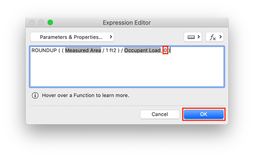

24.  Select Number and click the Parameters & Properties... button.
25. In the pulldown menu, under the Zone tab, select Measured Area and click Add.
26. Add a space after "Measured Area" and click the Operators & Functions button.
27. In the pull down menu, under Operators, select Divide [ / ] and click Add.
28. Enter the number 1 after the division sign but before the comma and click the Units button.
29. In the pull down menu, under Area, select Square feet [ ft2 ] and click Add.
wp-content_uploads_2016_06_Info_18x18.png NOTE: This unit should match the unit of the numeric value in the Occupancy Type title.

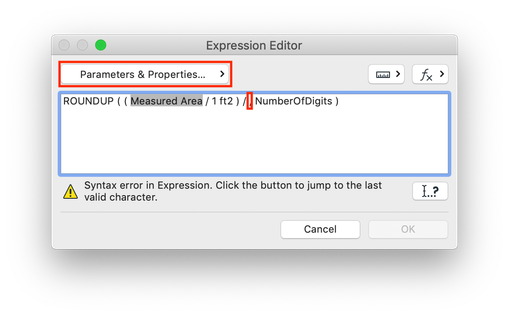

30. Add parentheses before "Measured Area" and after "1 ft2" and add a space after the second. Click the Operators & Functions button.
31. In the pull down menu, under Operators, select Divide [ / ] and click Add.
32. Add a space after the division sign but before the comma and click the Parameters & Properties... button.
33. In the pulldown menu, under the Properties > Zones tab, select Occupancy Load and click Add.
wp-content_uploads_2016_06_Info_18x18.png NOTE: This will divide the area of the space by the area need per occupant.
34. Select and delete NumberOfDigits, enter the number 0 and click OK.

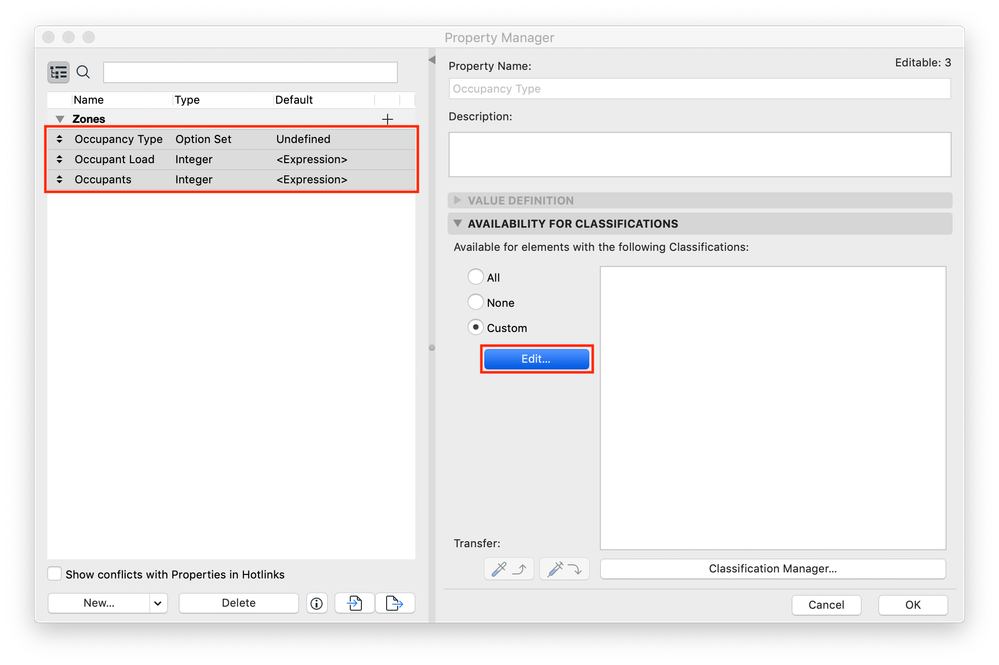

35. Select the 3 newly created properties, under the Availability for Classifications tab select Custom and click Edit...
36. In the Availability dialogue box select Space and click OK.
wp-content_uploads_2016_06_Info_18x18.png NOTE: This will allow the property being created to be used with zones in the project. If a different classification system exists in the file, choose the classification that is used for zones.

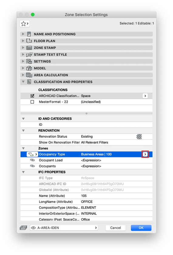

2. Select a zone and open the Zone Selection Settings dialogue box.
3. Under Classifications and Properties, navigate to the Classifications section. Make sure that the classification is set to the one associated with the expression properties created earlier.
wp-content_uploads_2016_06_Info_18x18.png NOTE: In this example, the Space classification needs to be enabled for the 3 properties to appear.
4.Under the Zones section, set the Occupancy Type for the selected zone.
wp-content_uploads_2016_06_Info_18x18.png NOTE: If left undefined, the Occupants will not be calculated.

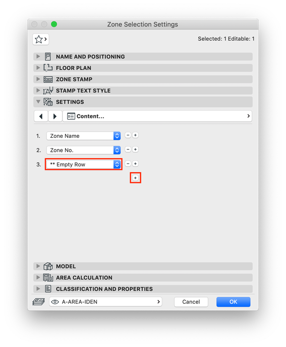

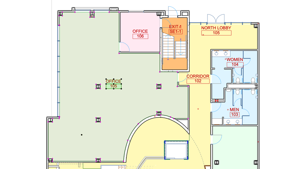

5. Under the Settings tab, navigate to the Content section and click the + button.

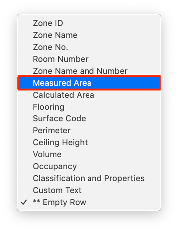

6. Click on the new field entitled "** Empty Row" and choose Measured Area. Click the + button to add another field.
7. Click on the new field entitled "** Empty Row" and choose Classification and Properties.

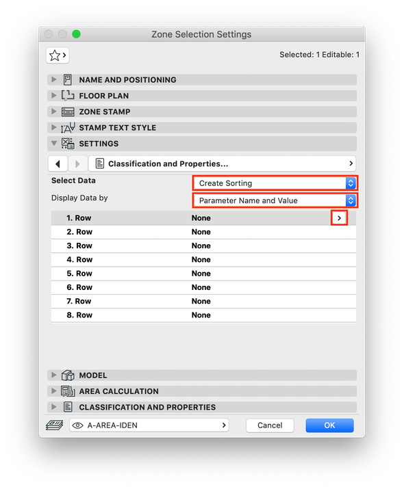

8. Under the Settings tab, navigate to the Classifications and Properties. Set the Select Data field to Create Sorting. Set the Display Data by field to Parameter Name and Value. Select row 1 and click the arrow.
9. Select the Occupants property and click OK.

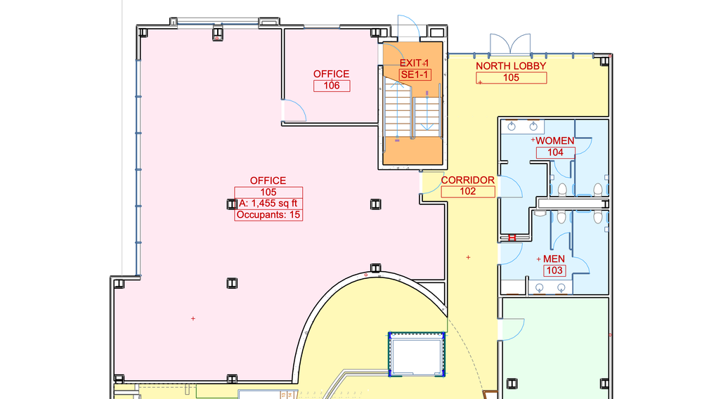

10. The maximum number of occupants will now appear in the zone stamp.
